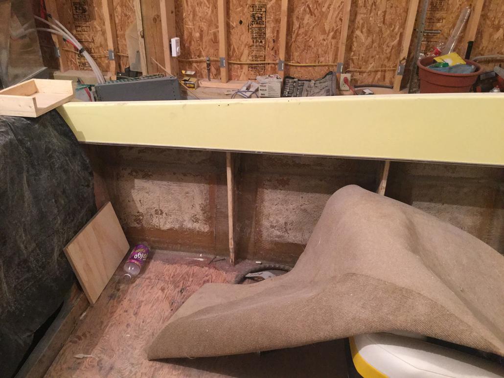

I have to ck that also. I've had some 1/4" luon that I was making some templates and molds with and thought I would use it cause it's so light and readily available. I need to make some side panels with carpet as well as something to rap the foam backed headliner with for the cuddy. Boat is getting ready for paint now.
