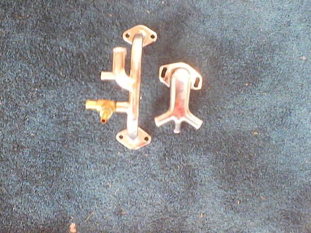

Hay Pudder 150.00 and it's yours if it will work,Stainless Marine minus the PFM valve.

Pudder I was looking at the stainless book and I think that mine will not work on your setup. It is called the( big block kit with bypass port entry).They offer quite a few kit's so if you call Stainless they could tell you if it would work.(305)681-7893

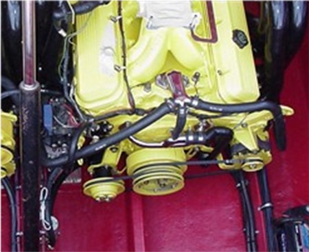

Puder I got mine from CP Performance and have run them for 3 seasons. I have the thermostat. Temp is a perfect 150 deg and never moves. 18# pressure at WOT. The work excelent and I was even able to use the factory outlet hoses. I did fabricate a solid hose going from the cooler to the bypass out of copper plumbing pipes and fittings and painted it black. Works great but I am in fresh water.
