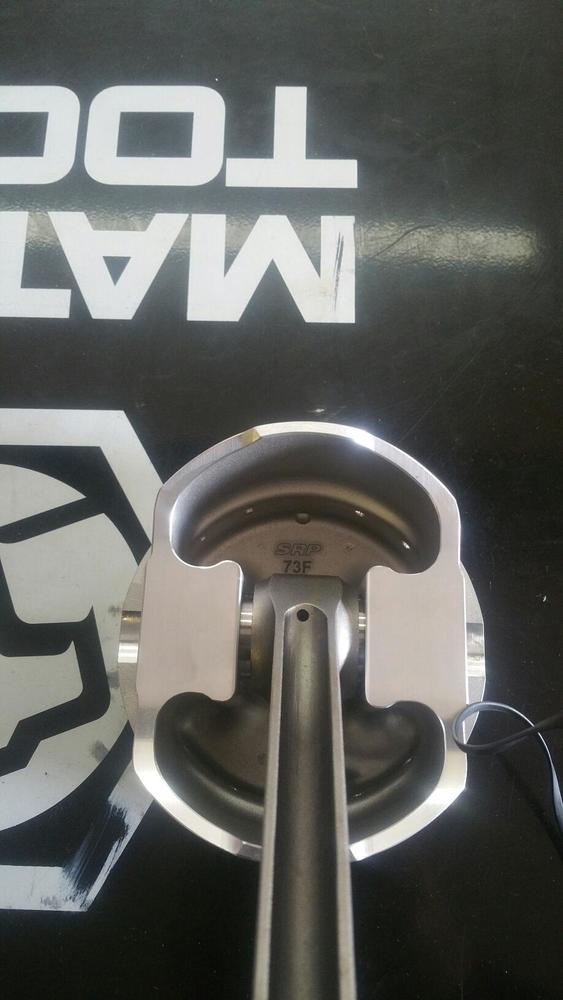

Boat didn't lean. Engine has 400 + hours. Riser height problems would have shown their face years ago one would think. Builder thinks it has had water pushed up a few times and this time I got unlucky. The last few years the boat only gets taken off and put on the trailer once or twice a year. Otherwise it sits on the lift at the lake. My money is on the y-pipe flapper on the starboard side. That is the most direct route for water to be reverted back up into the engine. And not that it would prevent water from entering, but I did not have the exhaust open when loading or unloading. Hopefully we find a smoking gun and not everything in place.
Engine bored .030 over, new SRP forged slugs and Scat H-beam rods will be installed in all 8 holes.
Attached Thumbnails Card in spokes noise from back of engine-boring-496.jpg   Card in spokes noise from back of engine-new-bullets.jpg   Card in spokes noise from back of engine-underside-piston.jpg
