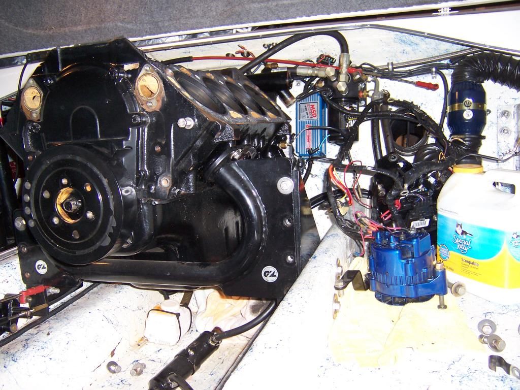

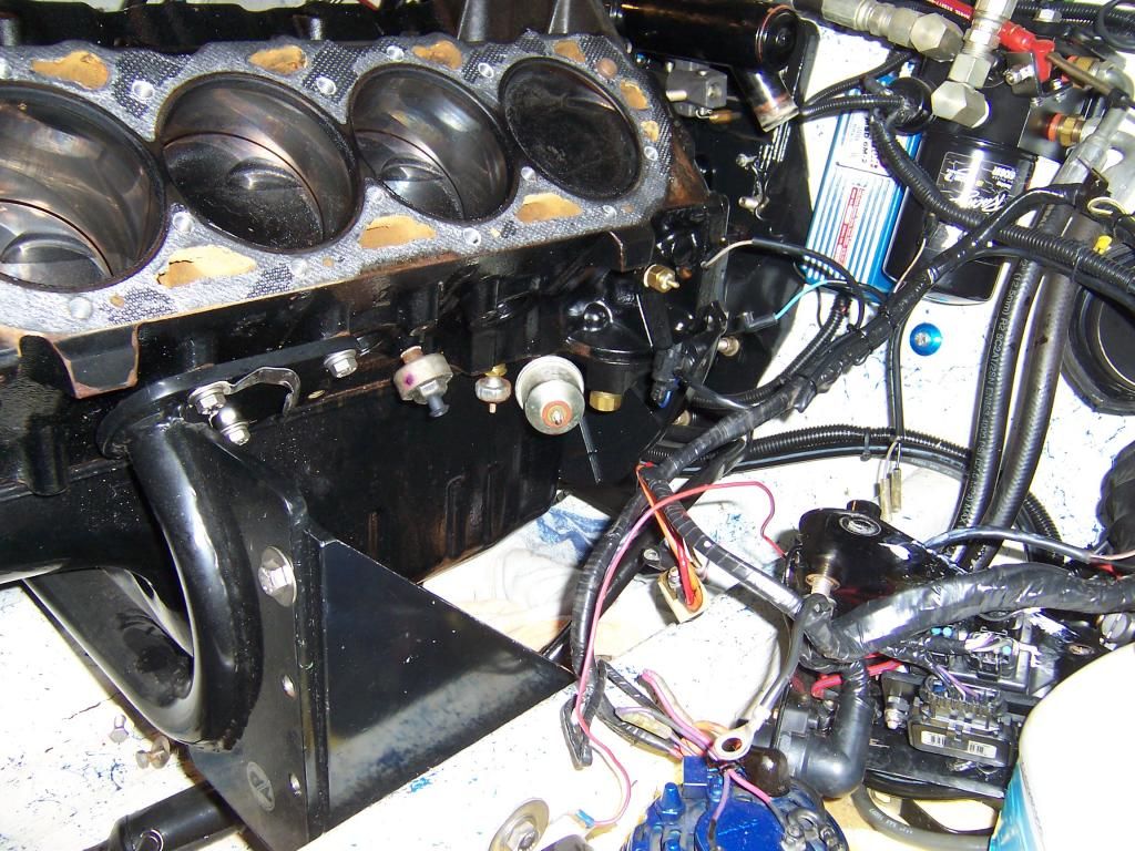

Old 10-17-2015 | 09:50 PM
the deep's Avatar
Fast Singles Club
Veteran: National Guard
Joined: Oct 2011
Posts: 4,042
Likes: 491
From: Raystown Lake , Pa.
[IMG][/IMG]
[IMG][/IMG]
