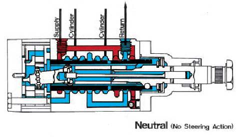

The pirate4x4 site had a lot of good info.
I have some background in hydraulic sys, but never dug into the inner workings of a full hydraulic steering unit.
I can see now that a gerotor is incorporated within the steering unit to pump fluid between the LEFT and RIGHT circuits when no P/S pump press is present (and the check valve has closed preventing fluid from returning to the reservoir). That's pretty slick!
Thx guys!
Just saw hallj's post. That backs up what I was reading while you were typing. Thx for the detailed explanation. It filled in a couple of gaps I had.
I found these pics on pirate4x4's site. They're not labeled very well, but I was able to figure out what was what.
Thx guys!
