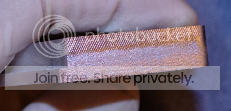

You mentioned access to a mill - depending on the how well the head is trammed to the table, what type cutter you use etc, you can make a surface that looks like someone cut it with a sawzall.
If you fly cut with too low spindle RPM and too fast a feed the finish will be rough and the leak path will be relatively straight lines from the water to the exhaust.
Not my photo:
Look at the top, that's not good. Imagine if there was a hole in that section, the leak path from the hole (your water jacket) to either the bilge of the exhaust - its a straight line. If the finish is bad enough, the gasket won't seal all the small valleys and you wind up with a problem.
Ryan

Gotcha. The mill is in my garage. Im not a machinist by trade, just as a hobby. My mill is trammed within .0005 and seems to produce a very nice finish. I understand what you mean now, smooth and flat, shouldn't be an issue.
