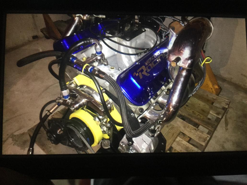

I've bought from cpperformance and jegs. Main reason I went with ss braided on fuel was due to a previous experience with an impeller going out on sea pump and cause marina was nearby and boat was in water for weekend I had them replace impeller etc. needless to say somehow they managed to slice water hose with razor knife by accident which leads to another story. It was about a 1" slit and not noticeable being on the under side of the hose however didn't take long to make a mess. After that I decided to use ss braided. I typically do my own work and tend to stay away from fuel, water and oil lines with with anything sharp but evidently some certified merc mechanics don't take as much percausion. Just thought I'd share my experience.
I have however used some pretty good reinforced hose that was extremely tuff stuff that came from jegs or cpperformance. Nylon and fittings were available from same vendor. Some hose comes with the nylon molded right on it. See pic below. This would be extremely difficult to slit even if you try.
