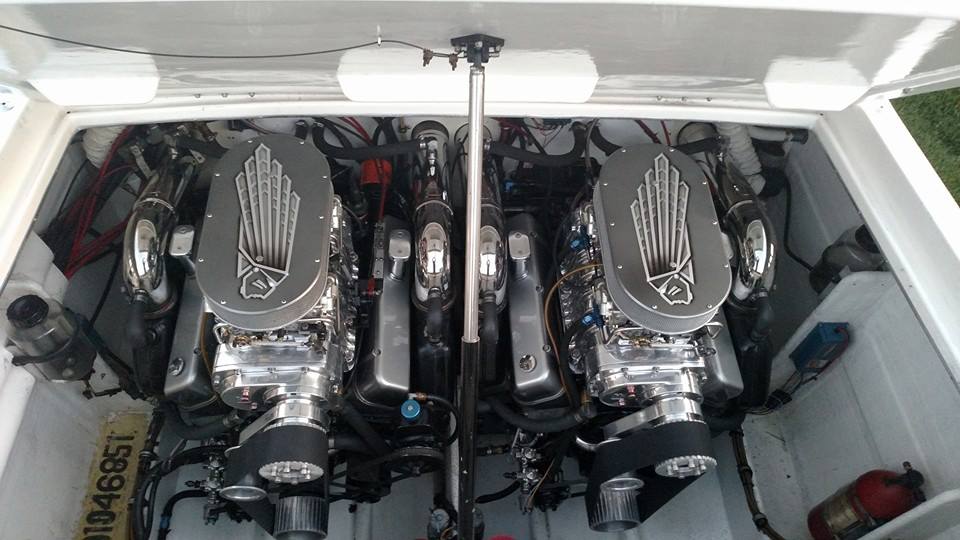

My engines are on either 32 1/2 or 33 1/2 centers, I can't remember exactly. With a tall deck and raised port style heads, the CMI Etops just fit without touching. Actually, the way the tubes are routed, they pipes sort of fit between each other. To get the header onto the head I had to lower the header down, slide it back and then lift it up into place.
Stainless Marine Gen II will fit on your centers without any issues as that's what I run. I tried to run the Gen III but they didn't fit and were off by almost a half inch. Stainless Marine tried getting them to work by angle milling the two exhaust flanges but was still off by a half inch. You need a 34" center to run the Gen III.

When I had engines marinezied with exhaust etc and sitting on the floor stands I can relate to what you were saying In regards to the tubes kinda intertwining to create a closer fit. By design for narrow centers or just luck I don't care as long as they go. So with what u said makes sense. If there is a will there is a way. Good to know though the gen ll's will clear as a back up plan.
Tks and will keep you posted.

yeah, they are offset by a half a cyl spacing. just like the other head on the same engine. so as long as they don't go forward or back at the very widest point, they will naturally intertwine...

The Etops were a PITA to get on and off and they got scratched here and there from having to lash the valves every year but they worked!
Gen II's fit with no problem. I also had Stainless Marine step the pipes up to 4 1/2" to help out with any power loss. I really wish I could have run the Gen III's though!!
