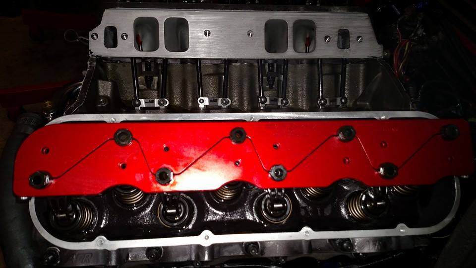

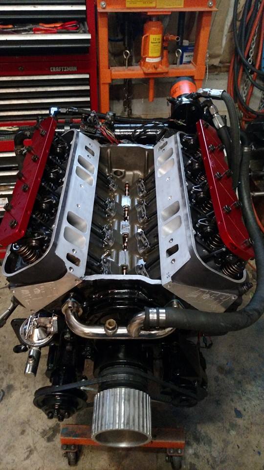

Originally Posted by Full Force
What valve cobvers you run?
I run the Websters also, with B&B/Stef's style valve covers. They're pretty standard covers that everyone sells. Zero clearance issues. When you install them you need to slided them up and down to find the centers where the studs line up perfectly and don't pinch. Pretty easy to do, just take care when lining them up so they're no too low or too high on the poly locks.
[ATTACH=CONFIG]564812[/ATTACH]
[ATTACH=CONFIG]564813[/ATTACH]
[ATTACH=CONFIG]564814[/ATTACH]
Attached Thumbnails Stud Girdle-girdles3.jpg   Stud Girdle-girdles2.jpg   Stud Girdle-girdles1.jpg

I have imco covers they should clear I would think, I will look at the Webster girdles, they look much nicer then afr girdles..
[ATTACH=CONFIG]564816[/ATTACH]
