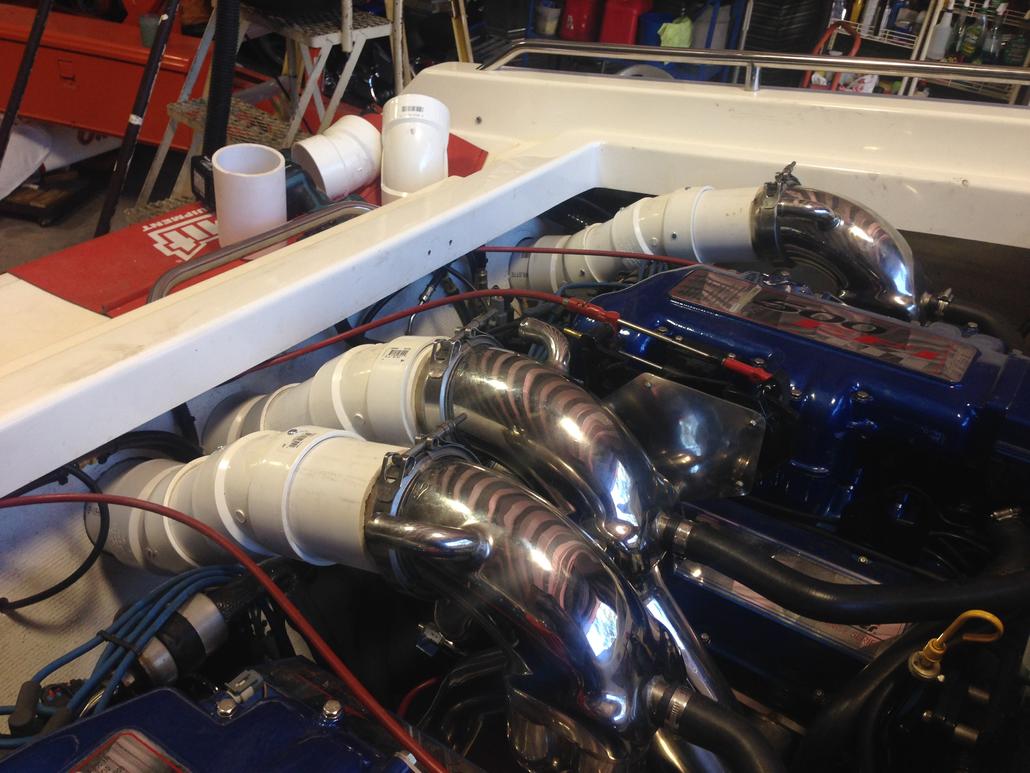

What we did was buy the 4 little pieces that mount to the header then used 4" PVC to mock them up. Ran screws through everything and sent them to CMI to make custom ones to fit. Worked great.

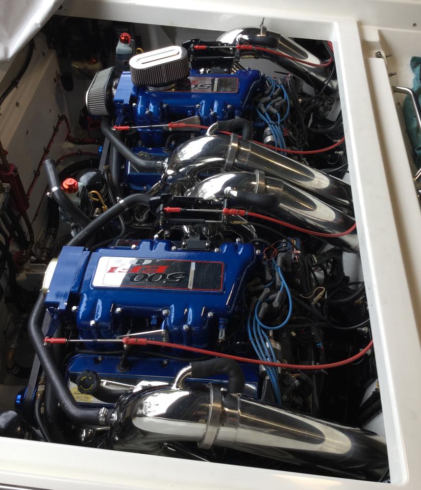

Port side definitely looks like a bravo, from the picture it looks like the starboard side has a kick up in it, not straight down from the flange. these where bravo's in my old Gun
[ATTACH=CONFIG]553358[/ATTACH]
[ATTACH=CONFIG]553359[/ATTACH]
I would definitely do that if I was unable to make these work. That's a great way to take all the guess work out of it for cmi.
Yes you can see the port looks as it should but the starboard definitely kicks up like you said. Why I have no idea. I'm gonna send in the two starboard shorter ones along with one of my port sides and have them match. I'd like to try and find dry ones about 12" longer and be done with it.
