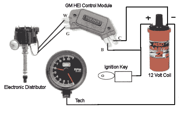

This may be what your thinking about
-Wally

Old 05-06-2016 | 08:58 AM
Joined: Feb 2005
Posts: 570
Likes: 47
From: cincinnati,oh.
Yes, thanks.
