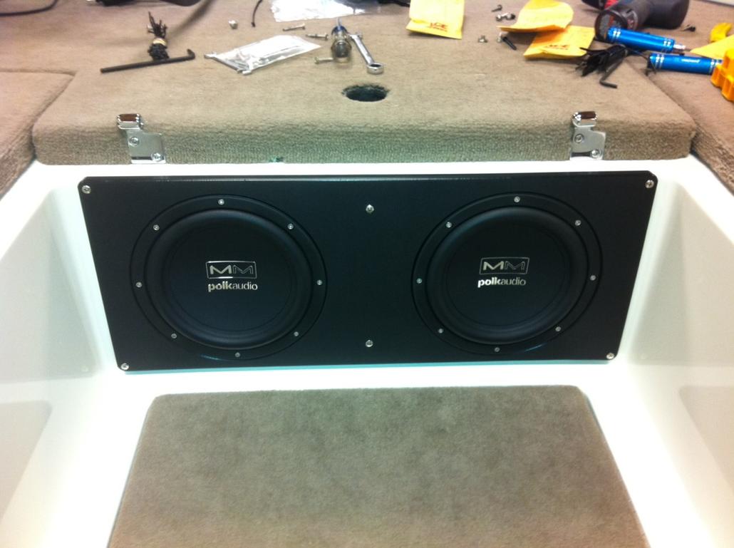

I built a couple sealed boxes for 8" subs in my fish and ski. Used 3/4" MDF and waterproofed with MAS low viscosity resin. Worked great and sounds awesome. Finish trimmed the install using black StarBoard material.
http://www.masepoxies.com/2-to-1-non-blushing-lv-resin
