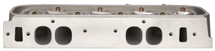

SB 06-23-2016 06:10 AM
In case anyone is ever interested, HVH has a raised oval port Brodix head that is around 300-305cc's.
I have the flow #'s somewhere, but in meantime , here is a pic. You can see how far the runners are raised.
http://image.superchevy.com/f/100889...ntake_port.jpg
Compared to normal oval port location
http://www.brodix.com/wp-content/gal...b-o-intake.jpg
