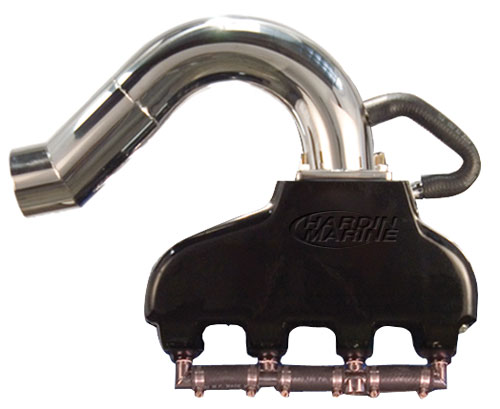

If you scroll down you'll see the HP500 replacement.
Here's the deal:
Merc had reversion issues with the Gil's with standard risers. Years later, and multi TSB's later, they came out with the taller riser. It worked a lot better, but some still got a little reversion. The HP500 was the last Blue Motor to get Gill's.
Link: http://www.hardin-marine.com/p-15730...st-system.aspx
Pic of the later HP500 tall risers
Here's the deal:
