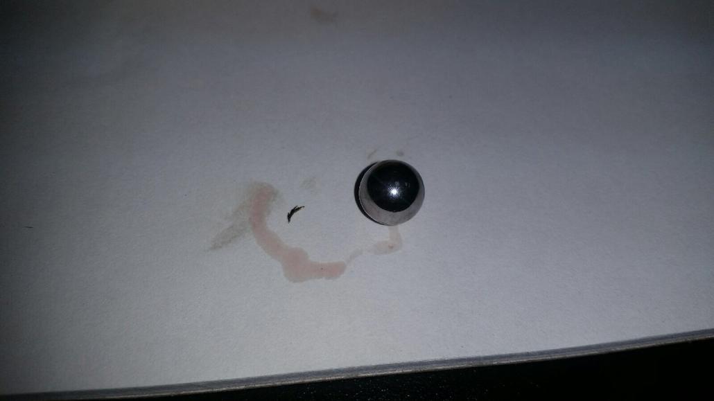

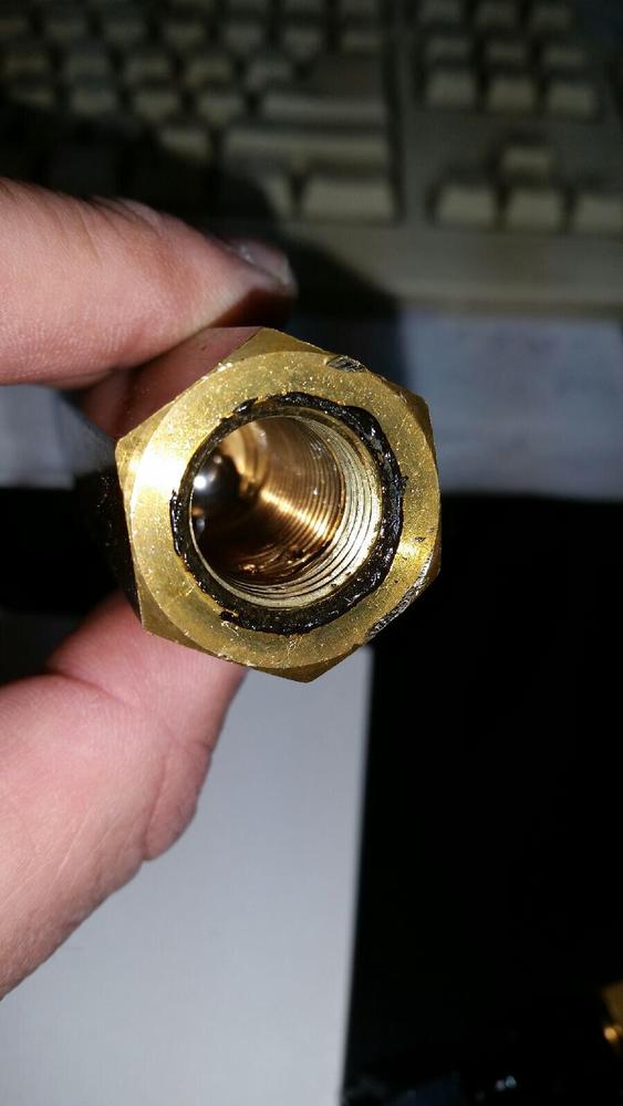

We just removed a check valve that seems to be broken. We started up the motors and at the boat lift it seems to be working now. I plan on going for a run tomorrow night to see if the pressure stays consistent. Will update

[ATTACH=CONFIG]556046[/ATTACH]
[ATTACH=CONFIG]556047[/ATTACH]
[ATTACH=CONFIG]556048[/ATTACH]
Not sure if this is correct? Does not appear to be.........?
