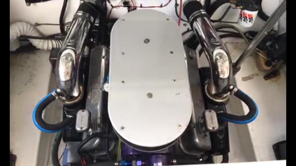

I've been swapping around risers due to fitment issues. I have Stainless Marine exhaust, and the latest risers that I have are for a Bravo setup, and they go almost to the tips (about an inch short before going into the tip itself). I was curious about reversion with my old pipes so I thought I'd see what these were like since I now have the Silent Thunder off the boat. I was surprised to see that the inner pipes were fairly wet! Farther up the pipe, I see that Stainless Marine had welded in dams that cover the bottom quarter (maybe a little less) of the pipe at its tallest point. Obviously, it is sucking water (which is a surprise because I thought roots-blown engines resisted reversion). Are the dams sufficient enough to protect the engine?
This is the engine installed in the boat with the latest risers. 454, 525 EFI cam, B&M 250.
Any thoughts? Thanks!
