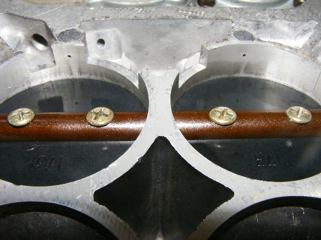

When setting up the carb, like all Holley's, it is very important to also set the secondary throttle blade's opening when closed at idle. They have an idle circuit too, but it's fixed since no idle mixture screws. Set blades so the transfer slots are square typically .020"-.030"

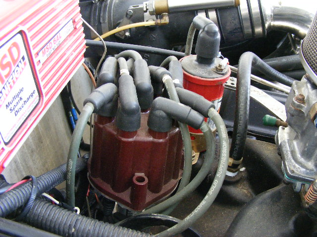

Does the MSD ign need to have a jumper installed/unplugged or something to check base timing?
I'm running a 6AL's, MSD Blaster coils and MSD distributors:.

Pulled both carbs.
The secondary transfer slots were not visible at all on either carb:
[ATTACH=CONFIG]559136[/ATTACH]
[ATTACH=CONFIG]559137[/ATTACH]
Transfer ports with throttle held partially open:
[ATTACH=CONFIG]559139[/ATTACH]
After adjustment of stop screw for secondary's:
[ATTACH=CONFIG]559140[/ATTACH]
When adjusting the transfer ports, I first backed off the primary and secondary idle screws, loosened all the throttle plate screws 1/4 turn and snapped the throttles shut a few times to center the butterflies and re-tightened the butterfly screws. They seem to be closing all the way without any binding. Next, I adj'ed the secondary idle screws to provide a square shape on the transfer slots (~.030" exposed).

In regards to the carbs; only thing I can think of is to re-adj the secondary idle screws so the transfer port is closer to .015"-.020" of exposed port.

Most set total to 34-36 on BBC with factory heads.
Your MSD has weights and springs (mechanical advance) under the distributor cap. See if the plate is welded or if the weight / spring system works.
