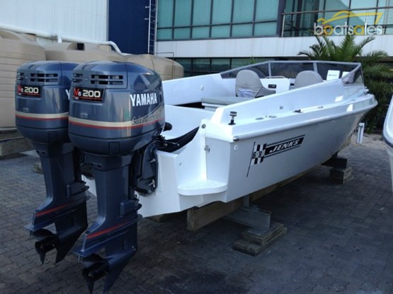

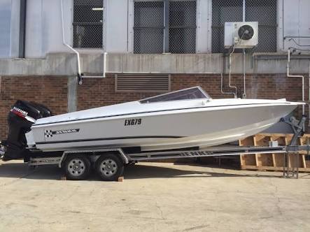

Here's one with twin 275 Zukes for 50k AUD in West Australia
[ATTACH=CONFIG]561366[/ATTACH]
[ATTACH=CONFIG]561367[/ATTACH]
And another with Yammies at Pier 35 Victoria for 49k
[ATTACH=CONFIG]561368[/ATTACH]
[ATTACH=CONFIG]561369[/ATTACH]
