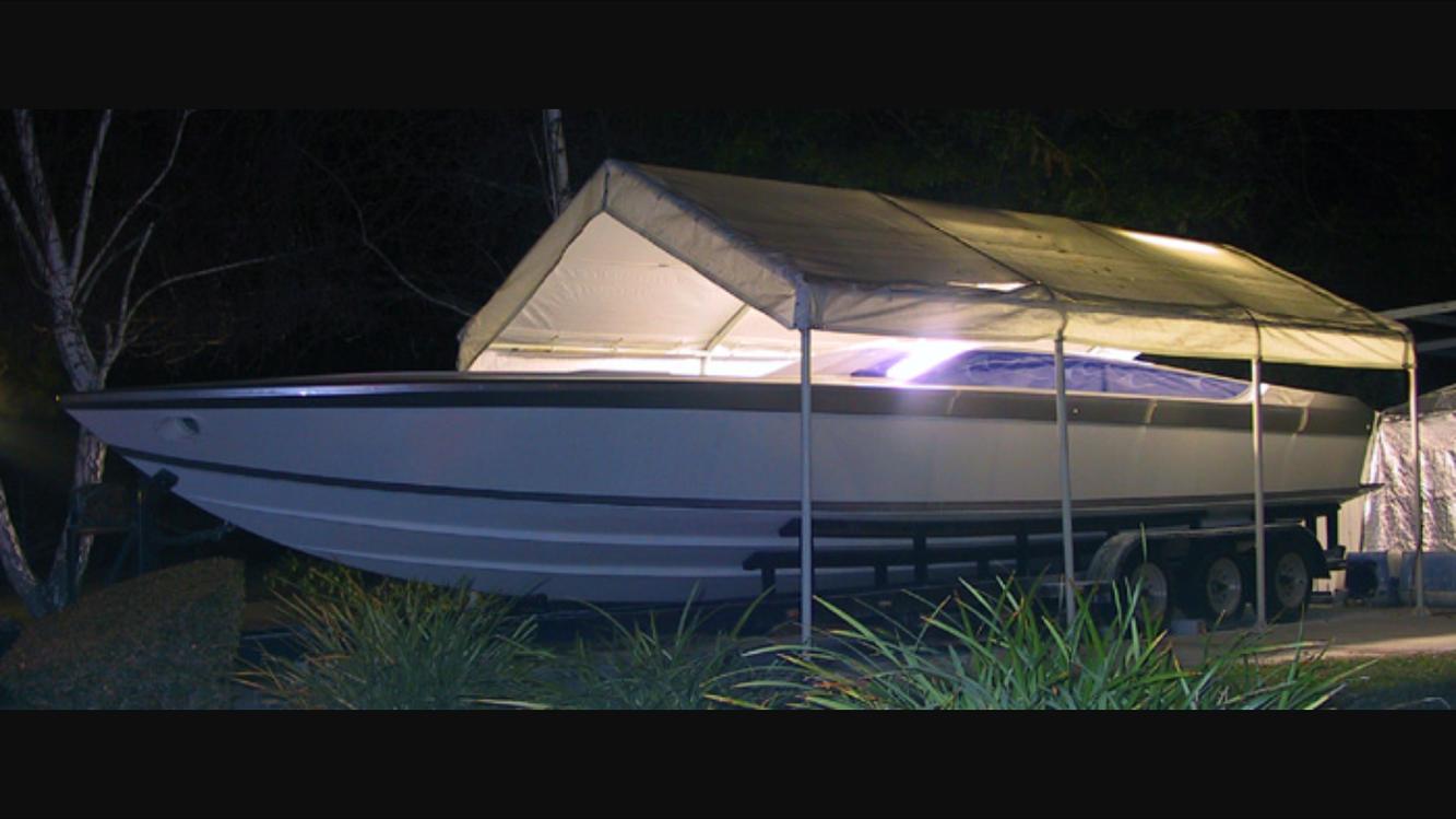

Either way it's real basic. Here's a carbon copy year etc with deck mods
