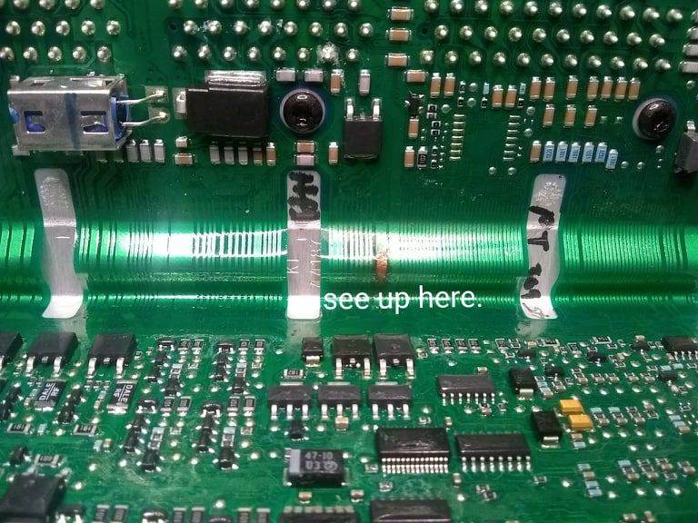

last week fix HP 600 sci and the recall was NEVER DONE - Blew the whole track and circuit completely out. The few that repair ECMs / PCMs would have said sorry your PCM is totally junk and NON REPAIRABLE but I keep at it and repaired the whole darn thing good as new actually better than new because of the better better internal components I installed Just saying.
The ECM / PCM 555 have some average components installed at best.. By far the largest group of failures in the whole marine industry not even close is the 555 s.
its 100 - ecm / pcm 555 s fail to 1 Econtrols ecm.
