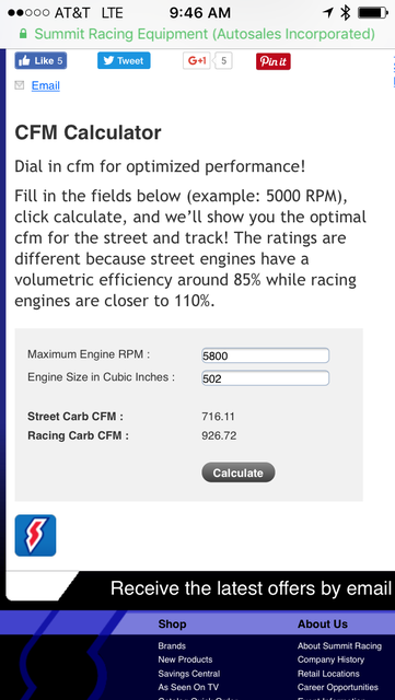

Summit has a decent carb calculator that at least takes performance mods into account. . It's not perfect, but for us neophytes it's helpful to get in the ballpark.
