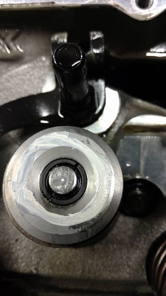

Here's an example of what you DON'T want to see.
[ATTACH=CONFIG]565414[/ATTACH]

Originally Posted by Panther
Any time.
What the.....

An engine I fixed last year
