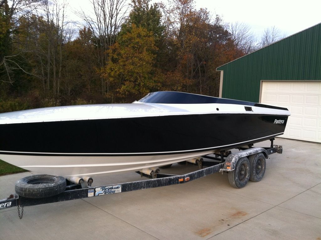

Ok fellas.
It's been over 5 years of blood sweat and tears (and buckets full of money) and this summer the old girl is going to finally float!
The boat:
77 pantera 24-7 (second boat so im sure its a heavy one)
Straightened bottom. No hook.
512 BBC with a bravo one done by Dick T. 1.65:1 ratio with a 26p bravo prop (stock for now until I have data for mods)
3.5" prop depth
Dyno sheet:
So, how fast is this boat going to run? I have an idea, but what does everyone think?

Post some pictures of the old girl...

vintage chromoly's Avatar
Joined: Sep 2011
Posts: 2,643
Likes: 18
From: cleveland ohio
vintage chromoly is offline

i think you will need a prop with more pitch&diameter,maybe need to add a spacer but some testing will give you answers.btw,the boat is looking good.
