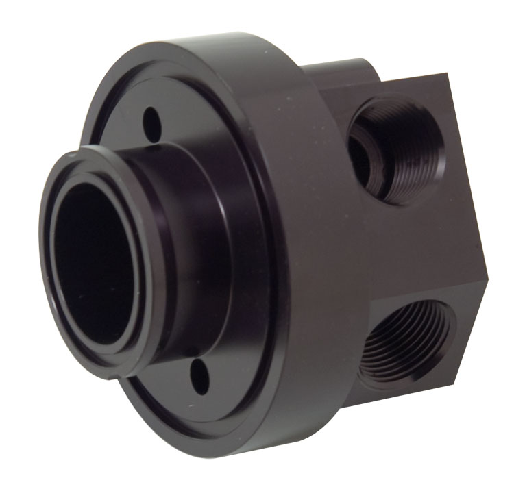

Do you have a gen4 or gen 6 block? They take different adapters.

Originally Posted by Boatally Insane
Yeah.. mine too..
http://www.cpperformance.com/p-14597...gen-4-bbc.aspx
and I AM running an HP filter.. Cut the last one open.. couple metal flakes still (long story) but looked ok....
It's a mark IV style Dart block...
