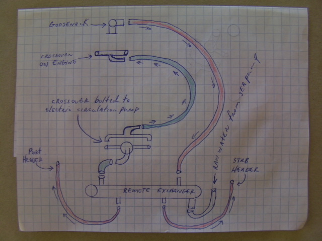

Old 04-29-2017 | 09:13 AM
Joined: May 2009
Posts: 1,942
Likes: 527
[ATTACH=CONFIG]566874[/ATTACH]
you have to buy these parts anyway so it's just a matter of configuration to try and keep the engine uncluttered
anything can be done,
edit in assembly, so the heat exchanger, electric circ pump and crossover would have to be an off engine assembly
mounted to a stringer bulk head or firewall,
