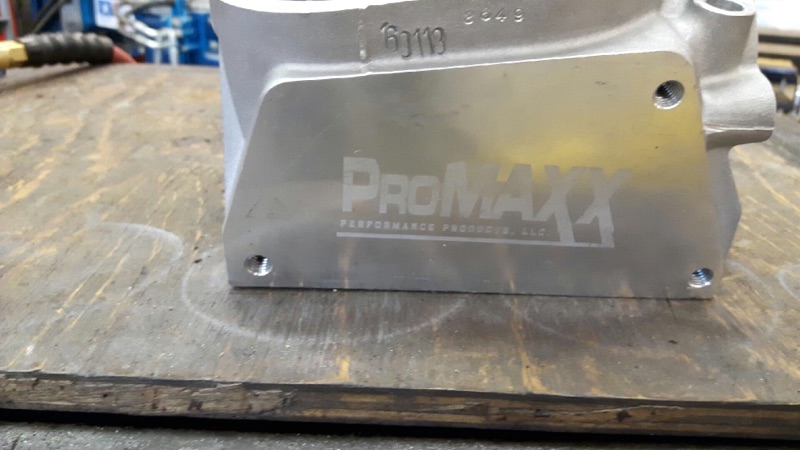

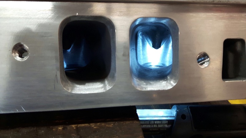

Heads getting final hand porting and polish along with some engraving. Al is wrapping them up as we speak and getting ready to ship. He will be giving me some flow numbers, and when I get them I will post them for ya!
