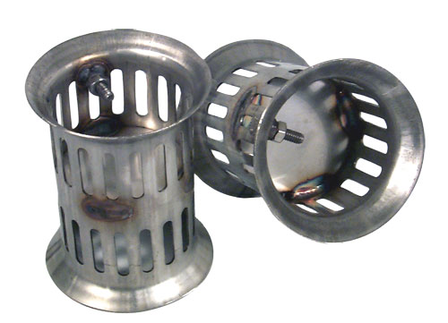

Thought I would update this thread. I still haven't pulled the engine to reset the cam to straight up, but have made several other improvements. First, we rechecked timing and we were only at 32 degrees, not 34. After several runs and plug checks I'm at 35 degrees and picked up considerably in the 3-4000 rpm range. Next, replaced the intake with an airgap rpm from edelbrock. After that it seemed to get up to top speed quicker but I didn't gain any rpm, still done at 4950-5000. So the last time out this fall, we pulled out the Hardin Marine" insert silencers from the exhaust hoses. We instantly gained 450 rpm and 6 1/2 mph. We went up 2" of pitch and gained even more speed. I'm still over-revving for how advanced the cam is, so planning to go another 2" up next time out.

Please recheck your carb jetting ! I have ran into several cars at the track that the exhaust caused same power loss as in your boat. One took 8 sizes more jet. Fact !
Now, that said, I had everything optimized...including jetting...with the previous joke of exhaust. Finally found the bottleneck in it (of course like you thought it was other things) and the car responded right away. Knowing that the exhaust system is one of the bigger influences of carb jetting I went right to it. 2#'s bigger and it responded. #2 more and it responded. So on and so forth. The other car had less of a bottleneck and took 2#'s bigger jets for best 1/4 mile speed.
So, if you where optimized go 2# bigger (frt and rears) and see what happens. If it picks up speed go 2# bigger. If need be. continue. If it doesn't respond, still check your plugs to make sure.
And thanks for posting your results. I've seen those mufflers and I always guessed that they would cut some power. Thus never used them myself and wouldn't know for real. They look almost like what sticking a potato in your exhaust would do.

I didn't fully realize he had those inserts in. I've personally documented a 500 rpm loss with those inserts as well. Idle dB cut by 6 but top end rpm by 500. If you want inserts that cut 6 dB but don't limit rpm get the GGB inserts. They sound better and the engine will not be restricted. No fuel changes were required (I run full time AFR).
