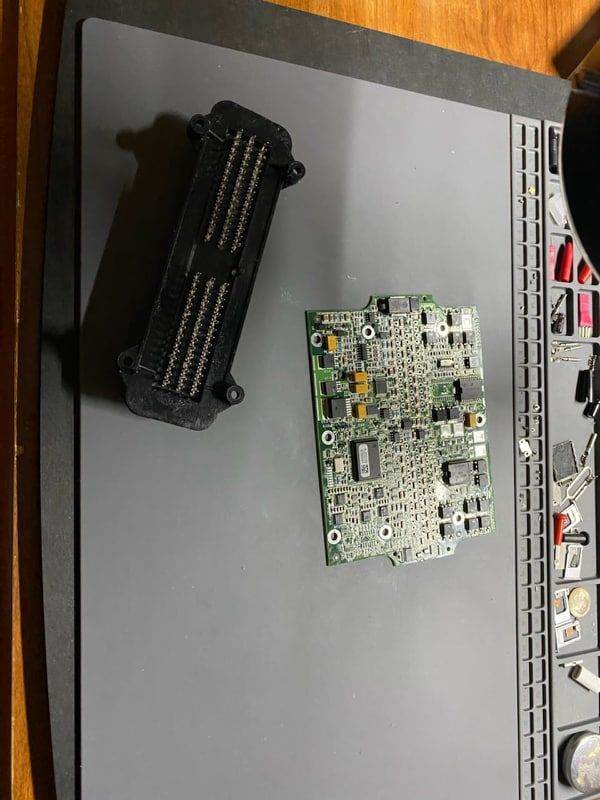

For OP here Hi perf 2000 and many others - His issues was NOT rare but there was more than one issue going on here. During thru out on my end I keep trying to find out why the 555 s fail more than any other ecm / pcm in the marine world. Yes they fail more than any other ecm / pcm by far. Anyways I called HP2000 back months later to see how all was going plus I had some news what else I wanted for him to change out on his engine side to help against a failure again. He reported to me that his NEW and mine repaired PCM both were doing the same thing as before.
Anyways I told him to send it back to me and I will warranty my end. Also I needed him to change a couple parts out to new on the engine side as well cause the failures will keep happening no matter if the PCM was new or a repaired PCM. Once I fixed his pcm again - He wanted me to overnite it and he would pay for that end. . I also saved him overnite shipping costs from a discount I get at Fed Ex. . End of the story, he is all fixed up and running well FINALLY.
The morel of the story here is ALL PCM failures have more than one internal issue and 80 percent of the time --- the cause was from on the engine side and or -- battery side and or - cabling side and or - VOLTAGE or a person self inflicted the damage -- all those ends need to be checked and or fixed as well. ECM / PCM s 80 percent failures are cause by something on the engine / boat / battery / person side. -- if that side goes unfixed then the ECM / PCM failures will happen again and again and again always.

BUP 05-17-2020 12:52 AM
https://cimg8.ibsrv.net/gimg/www.off...854fd41788.jpg
BUP 05-17-2020 12:54 AM
https://cimg1.ibsrv.net/gimg/www.off...864293273a.jpg
