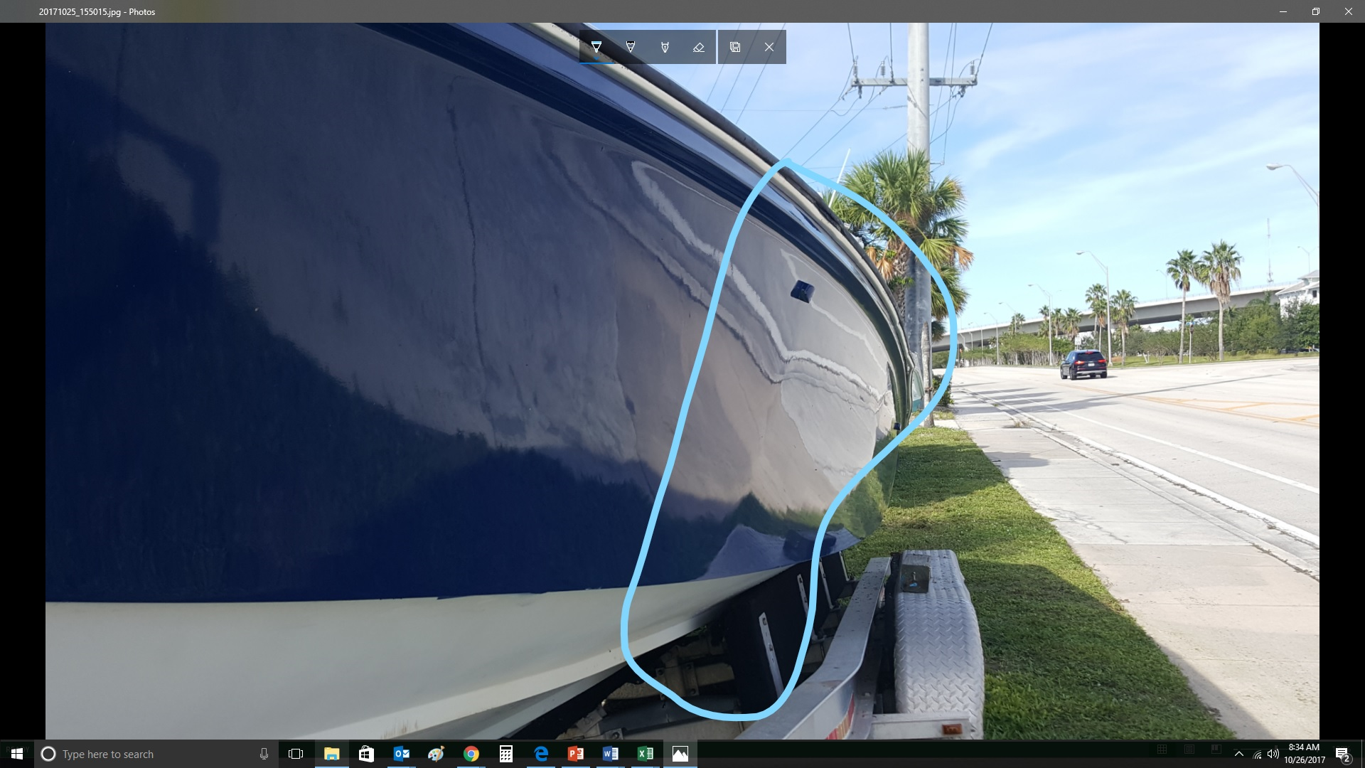

trying to see if anyone can help here -
am i nuts or does this look like a potential HUGE issue with the hull - just from looking at the "Vertical Wrinkle" in the paint....?

Yes get a membership and post some pics. What your saying isn't completely making sense. Is it below the water line where the problem is or are you thinking cosmeti cracking in the gel coat. The wrinkling part is what is not making sense.

ok - thanks for the heads up on the membership and the pics - you'd think the site would say this -....anyhow..
Here we go with some pics -
yes above the water line - as shown with circle (well my *** up version of circle) thx

Looks like maybe a bulkhead built there.

I've been staring at it for several minutes now and that was my thought also but then where the blue line is drawn around the area mentioned looks like it would be back to far. The one line / crack forward of the drawn line is what I initially was looking at. I see every part of the road lines and grass clumps in the reflection that's for certain. Kinda of a bad angle honestly.

My AT has a similar line from the where the bulkhead is mated to the hull. I've had the boat 10 years and it has not changed at all.
My hull sides white at that point and I doubt anyone else even notices it. I'm sure it would stand out more with a darker color.

That's the bulkhead, if you go inside you can see the bulkhead mated to side of the boat..
