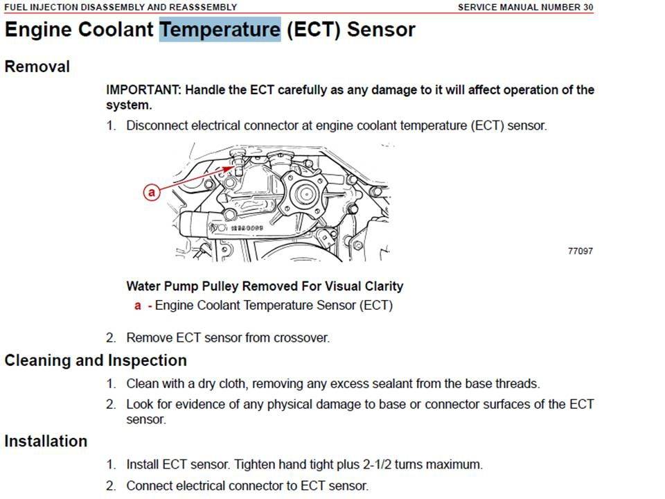

Use an IR temp gun on the crossover housing to verify its not over heating. If its not then probably need to replace the engine temp sensor (805218T)
which is behind the water pump pulley
Item 7
