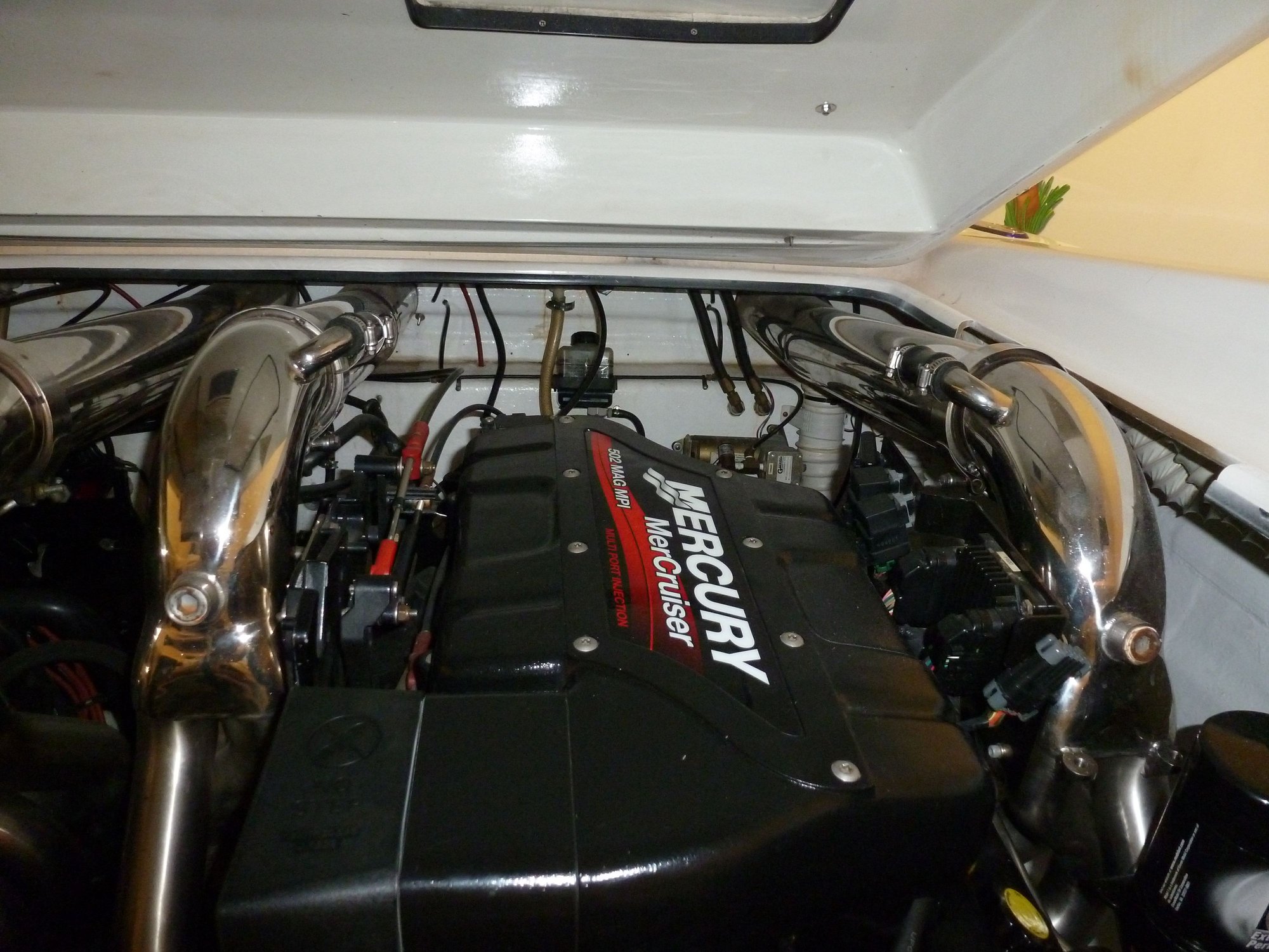

The brackets are an additional cost option from CMI.
IMO,Its easier to just bolt the linkage to the transom.
This is a pic of my older CMI's on 502mpi's
