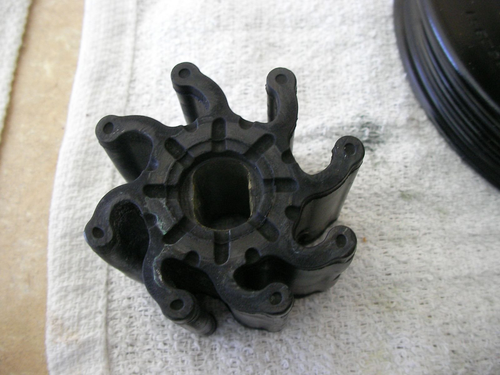

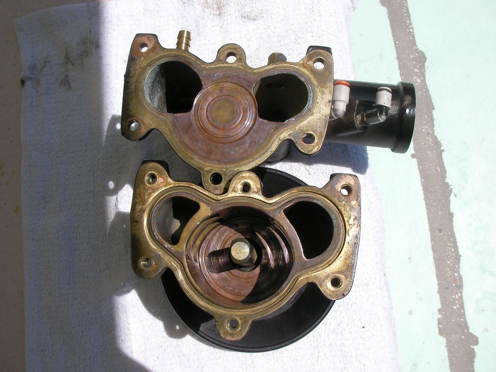

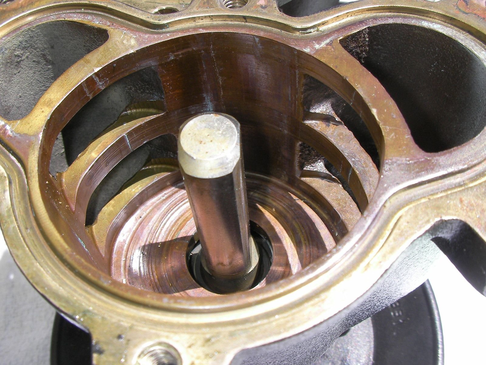

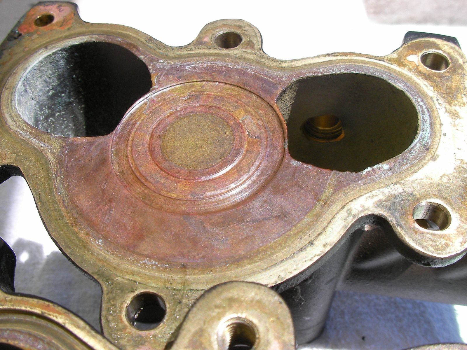

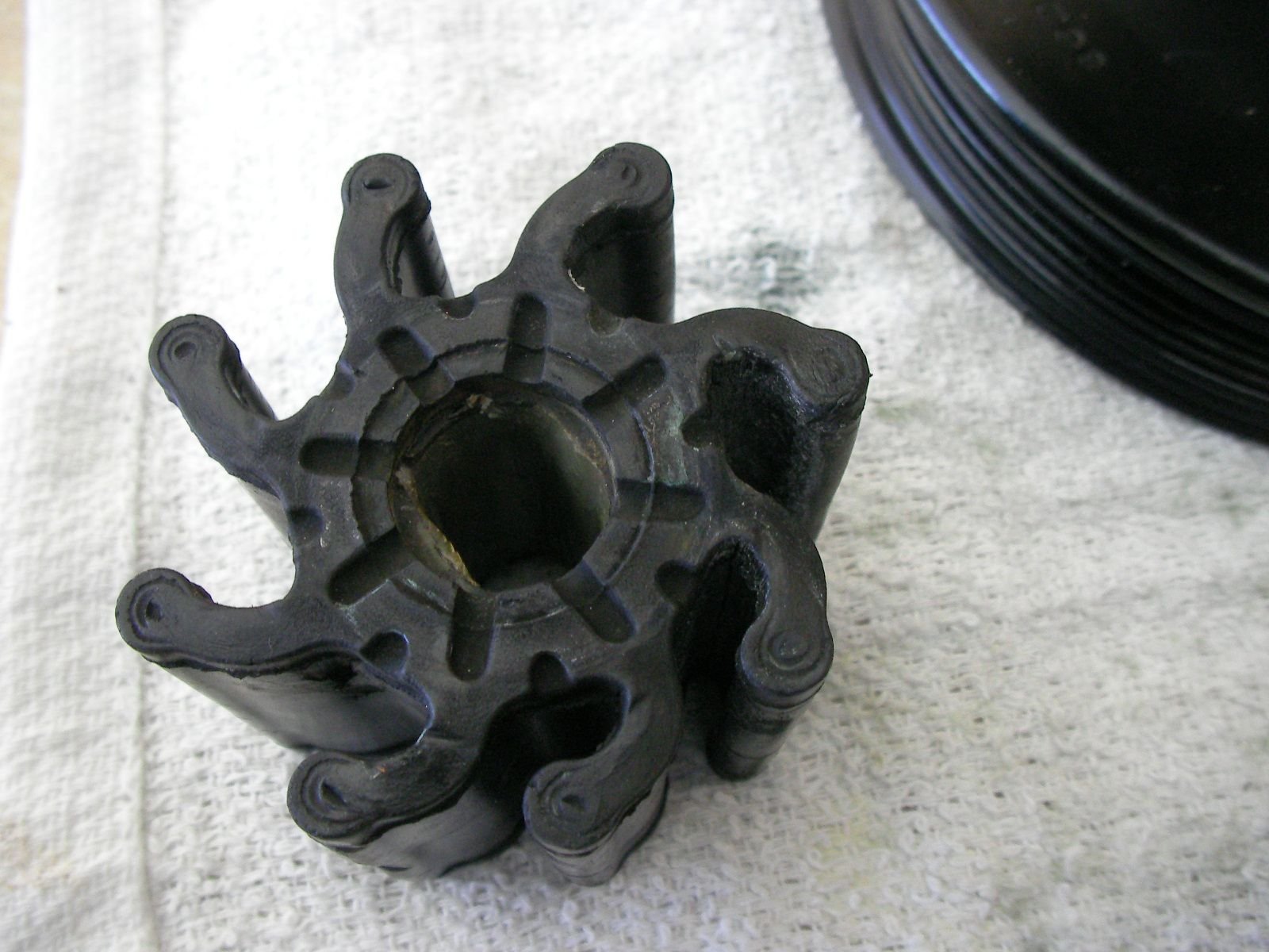

500 hours on engine, unknown hours on impellor
first impellor pic is rear cover wear, 2nd is down in pump.
why no replaceable wear plate, the college boys design it out ?

and someone needed more impeller changes as well. That formed a set with the rolled over blades long ago. That alone increases wear on top of when running.
The wear is nothing new. Very common since 2001.
Merc new pumps are way better now and alot easier to service by far.
Sea strainers help and more impeller changes helps alot as well to slow down the wear.

thanks guys,
i watched a hardin marine video on their upgrade and turned it off as soon as they said
to reuse the rear section. then i searched on here and found out it's common so it'll just get
cleaned up and re used.
the new impellor kit is from mercury, plenty off room around the cool fuel and sea pump so annual
replacement won't be an issue

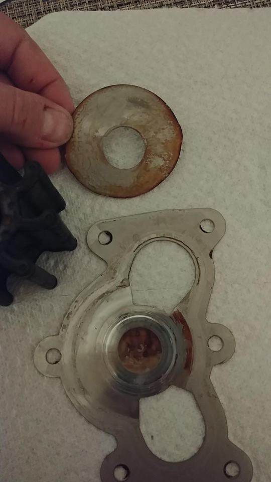

I would buy the one with the pulley as its already bolted to the pump from CP / Hardin. Yes its 100 bucks more but also a better looking pulley as well. I have found better belt alignment using their pulley already installed rather than pulling the old Merc pulley and reinstalling it. Keep in mind - better belt alignment can add to IAC longevity. Belt dust is an IAC killer.
Like I said the wear plates will wear and can rust.

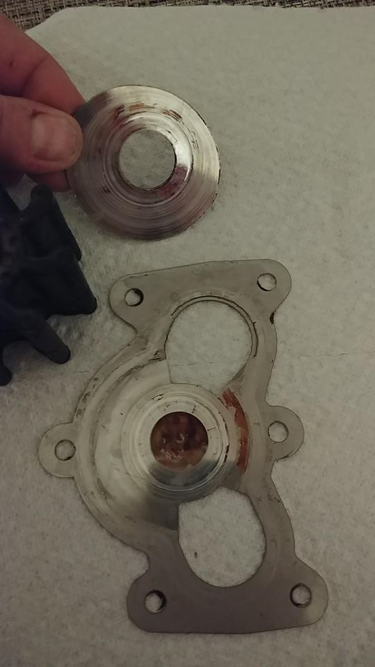

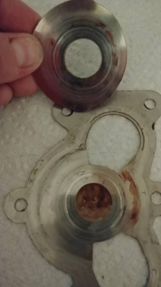

These next pics are from a one year install by me of the CP / Hardin Pump - their pulley installed and their wear plates kit. The wear plates still groove and need replaced 2 years max or even less including New OEM impeller. Again one year old install and about 90 hours of run time on LAKE TEXOMA. Yes a Lake not salt water running.
I would use the CP / Hardin housing / pulley / kit rather than Merc set up inwhich is internally soft anyday of the week.

back side of the drop in wear plate.
