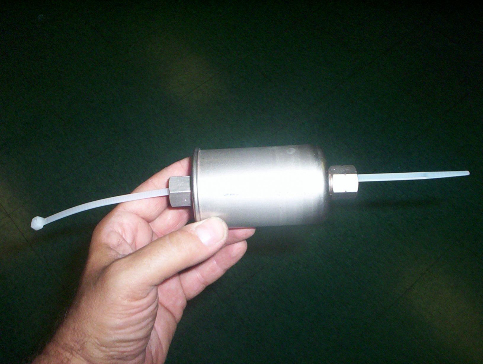

Also here is the boost pump filter some of these right out of the Merc box. . And yes these are my pics not net pulled The tie wrap thru the filter cracks me up and the these filters are not cheap but yes cheaply made. Brand new out of the box. Seen so many installed this way as well..
