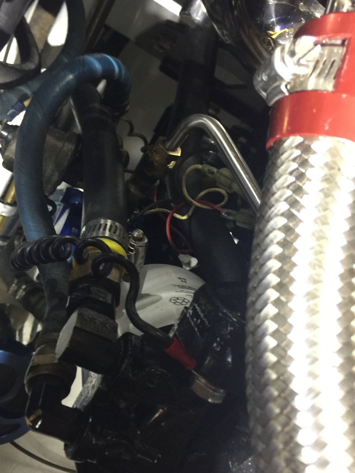

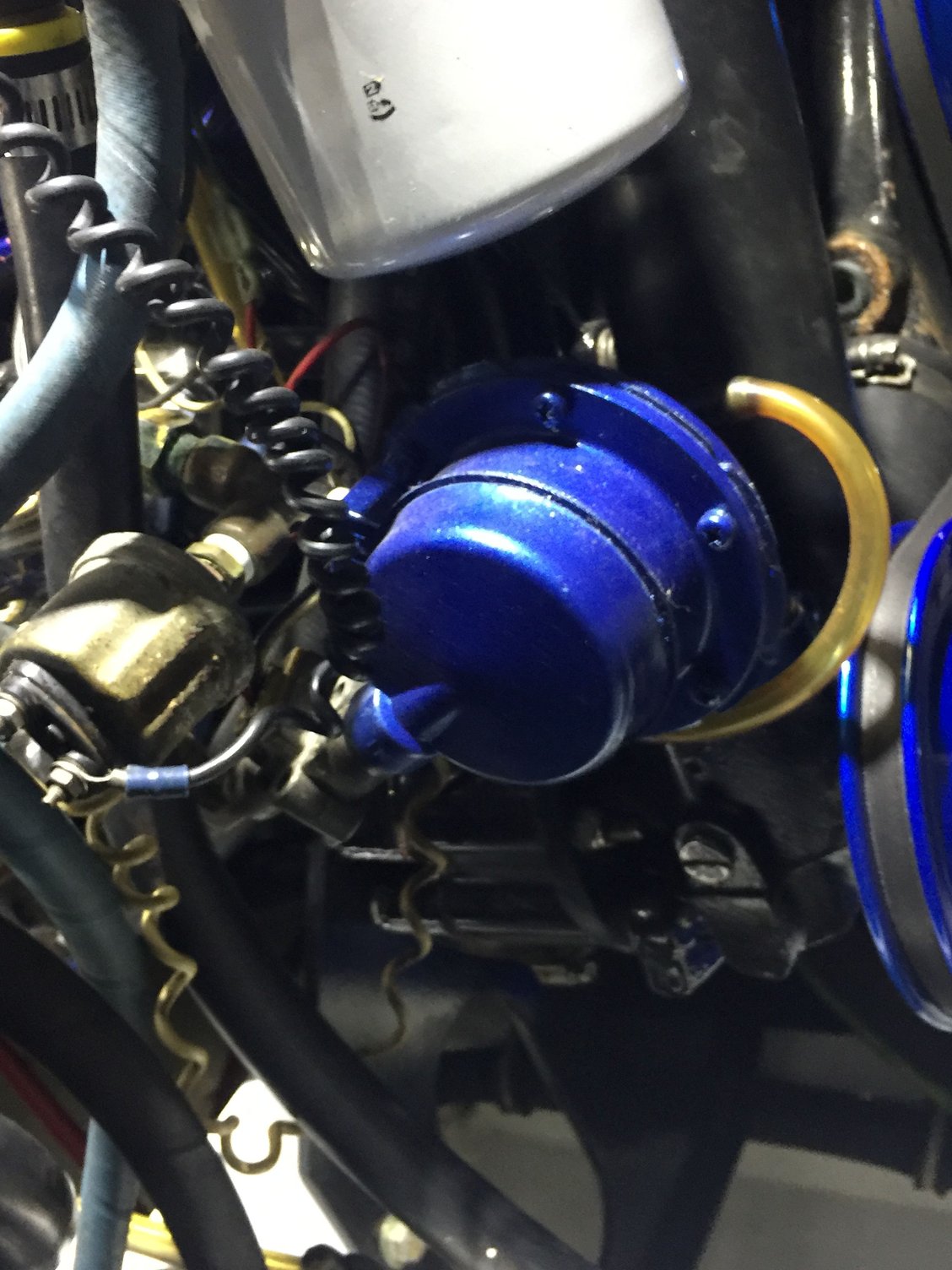

What should the fuel pressure be on a 1996 525SC? Also anyone know the best replacement mechanical pump, I’ve seen them from $75 - $250? Plus the part number mine needs (861677T) has the inlet and outlet head orientation is wrong! Unless it’s okay to rotate the head?

I just swapped in the Airtex 60932, I had to also rotate the "head" for the fittings to work correctly. Both of my engines idle around 6.5 psi
I plan to add the KE upgrades from CP performance but I needed to start with new, complete pumps as my pump levers showed a lot of wear. I replaced both sea pumps at the same time.

It should be at least 5# and not more than about 7#.
