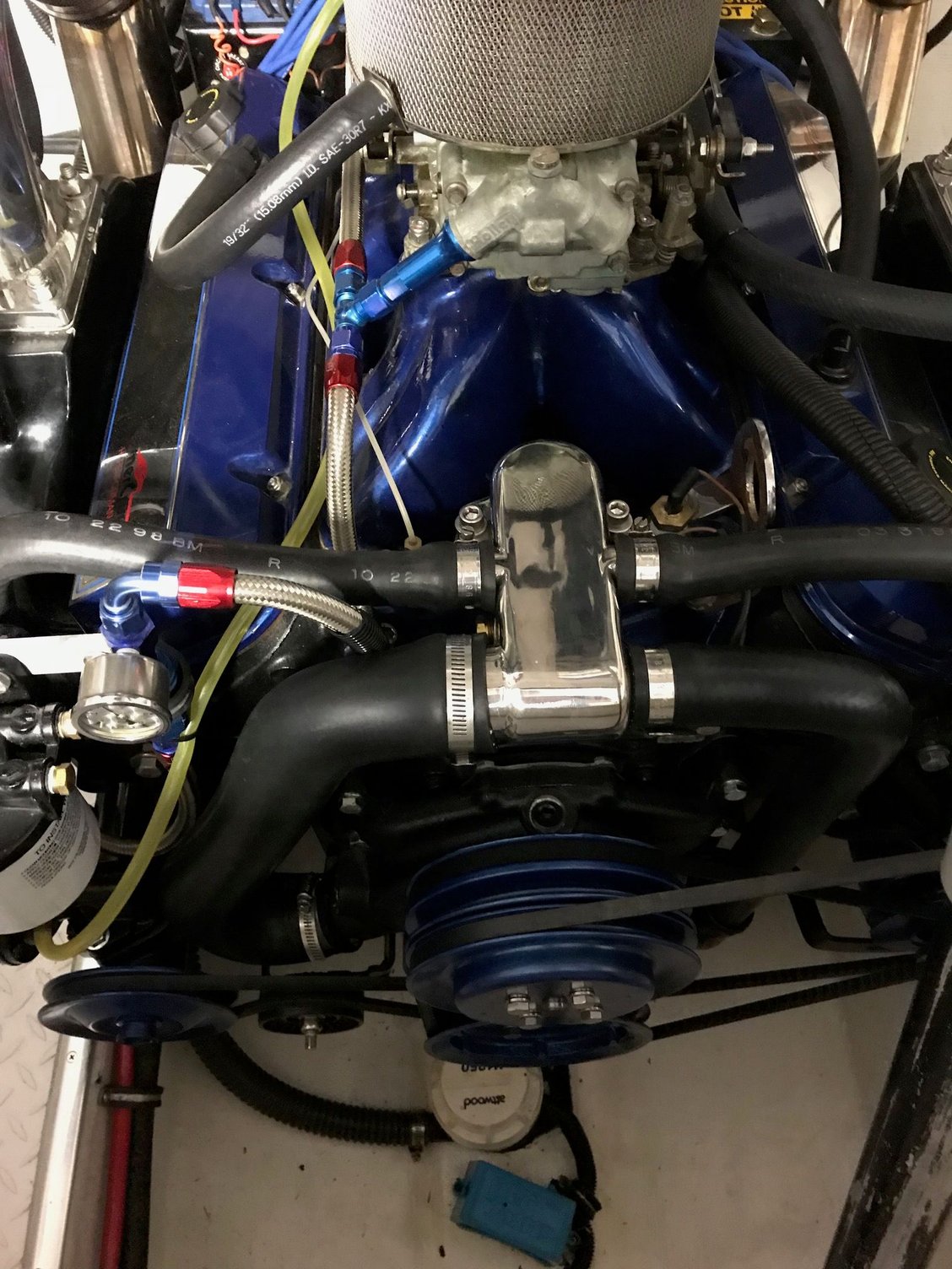

I bought that same Sierra set up and had to ream the mounting holes a bit to get it to fit right. I had same issue with the bolts that were binding and wouldn't line up right, also has to use allen headed stainless bolts to clear. Keep in mind this was not the OE set up for me and I believe the 502 MPI used 12 point headed bolts too.
How long ago did you get yours? I'm wondering if there could be a bad batch. By the way, that looks pretty dang sweet!! Mine is off by almost .080.

I bought it out of the swap shop new in the box a couple a months ago, not sure how old it was. When I googled it there were a few folks stating they had to ream it out as well.
