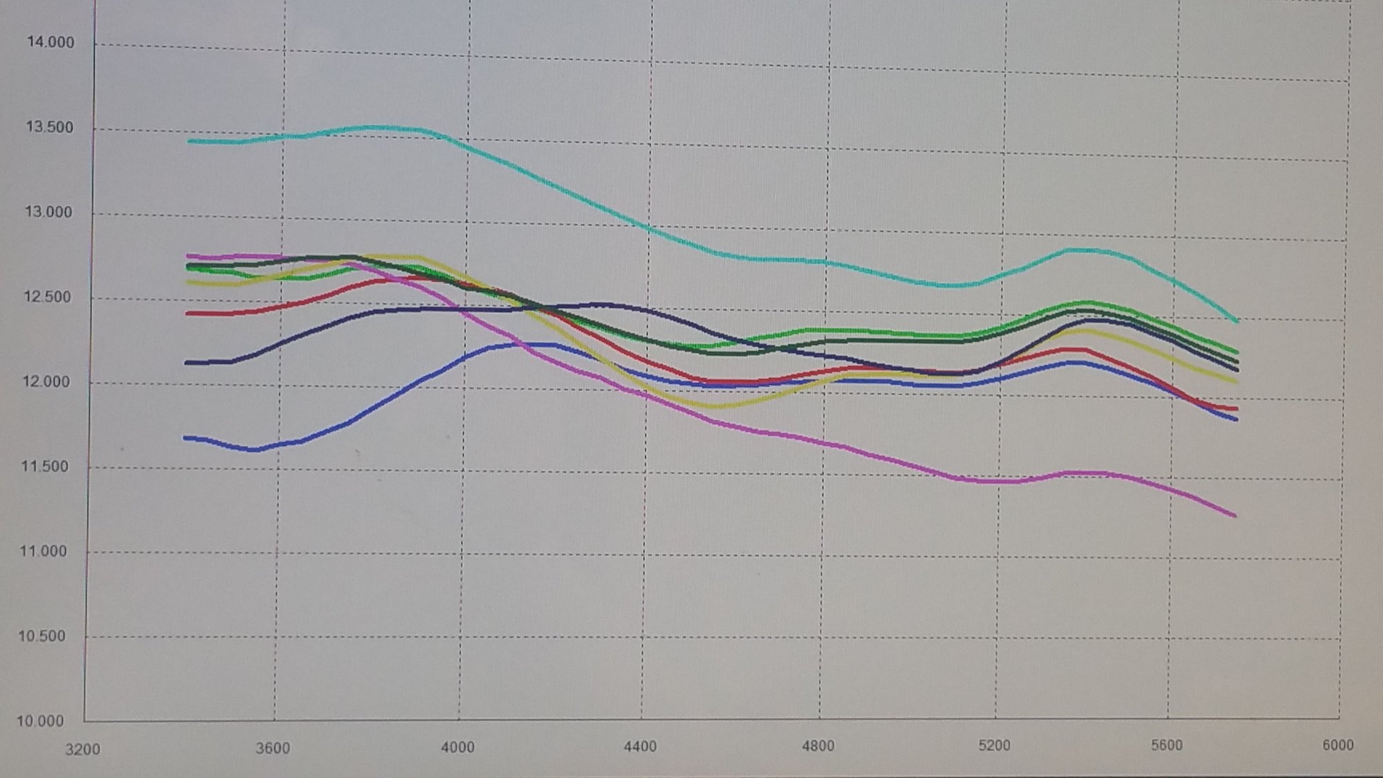

This motor had freshly flowed injectors that matched within 4% or so, about 1.5 pts of afr delta on top end with # 1,7 and 8 signifigantly hottest so if your tuning reading plugs look hard at THOSE!
articfriends is offline

This was with the batch fire injectors firing every revolution (set to double fire vs single fire), if set to single fire like a 502 mpi is stock those deltas are more like 2.5 to 3 pts apart fwiw!
