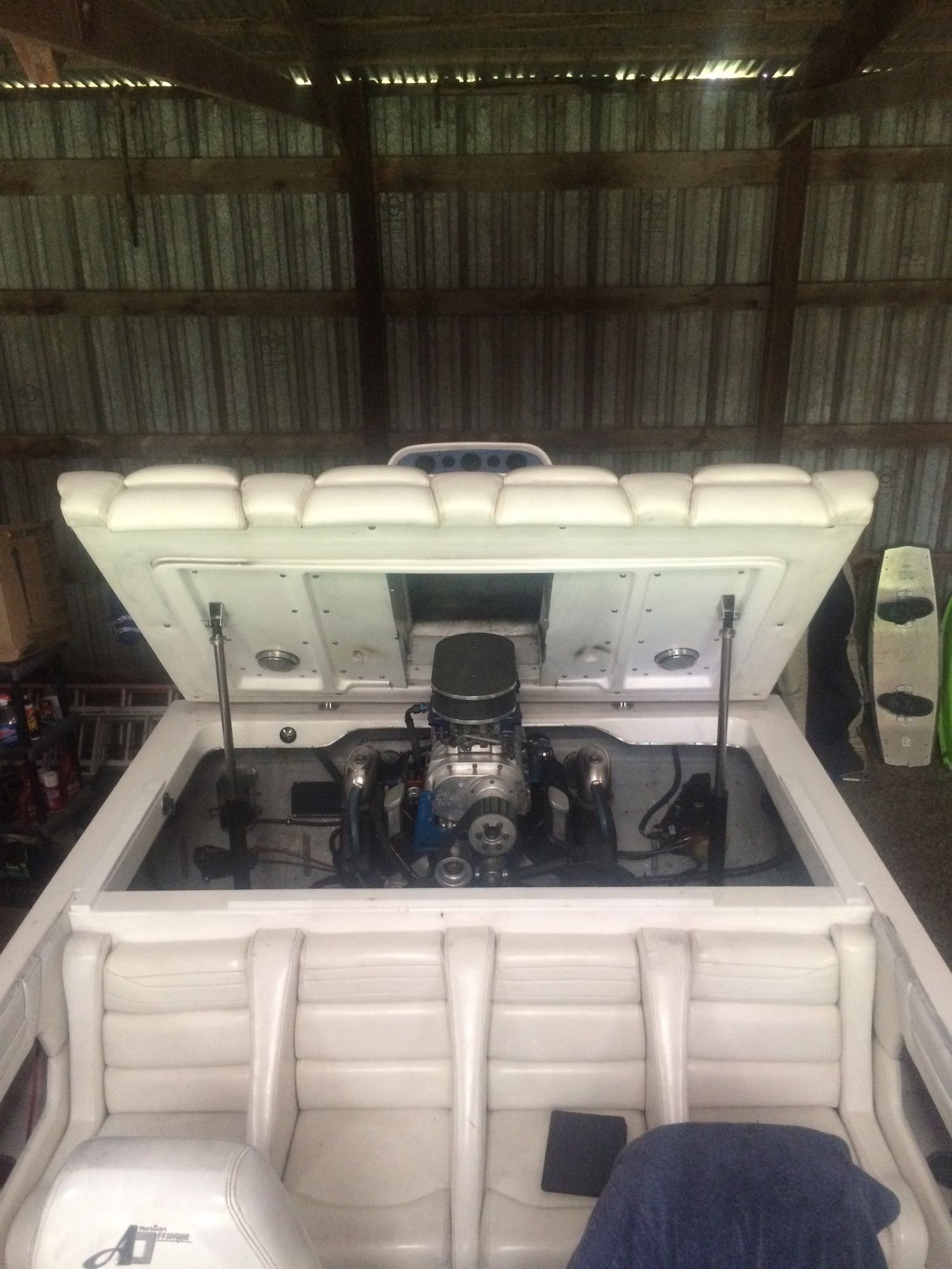

Ok how much additional expense and headache is it worth to go forced induction?
I currently have an HP 500 Carb motor and am wanting to bump it up to around 650ish. Anymore than that and I’m assuming I’ll start running into start running into exhaust and drive issues(have an standard bravo with XR gears and a sportmaster -2 lower). I don’t drag race around or anything just looking for a little more pep in the few evening hot laps I make.
I’d like to keep everything under the hatch witch eliminates a roots blower and leaves me converting to EFI and going with either a whipple or procharger. I’m assuming by the time I get the kit and whatever I’ll need to convert over to EFI this will be a decently sized bill.
As I’m only wanting to go to 650 I’m reasonably sure I could get some nice aluminum heads, a bigger cam, maybe a bigger crank and go to a 540( I don’t think I would really need this either), and a bigger carb and that would get to the same HP for a much cheaper price
I know blowers pack a much better punch with better torque curves but in my case I’m thinking the price difference won’t be worth it. I’ve never owned/driven a blown boat before so I don’t know. What are the groups thoughts ?

How heavy is your boat? Single engine? Use of the boat?
In my research the centrifigal chargers make so much power up top needing a huge prop that can be tough to jump out of the hole with. For my purposes of family fun and wakeboarding it just wasn’t the right fit for me.
