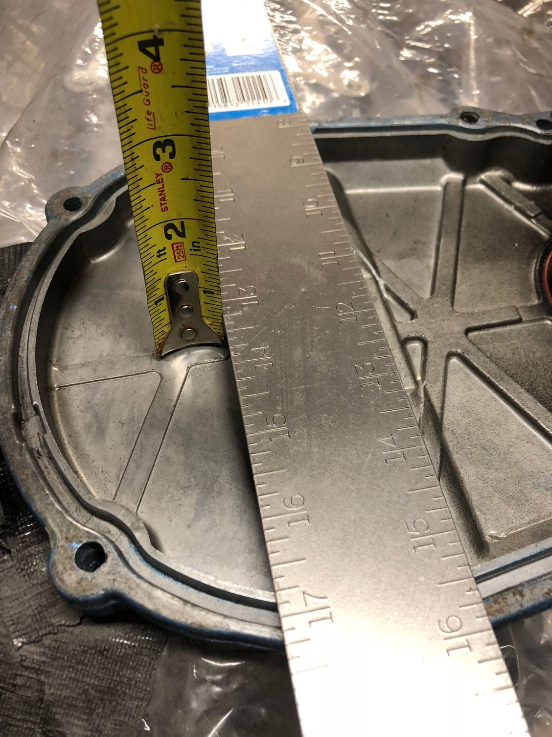

Originally Posted by Mohavvalley
Anybody know how many inches deep the stock gen 6 timing cover is?
I've got a gen 5 cover I need to compare to a gen 6 and see if I can fit the rollmaster doubble roller CS2095 under .
A fat 5/8” over the cam sprocket.

Thanks Rooster, I'll check the gen 5 tomorrow.

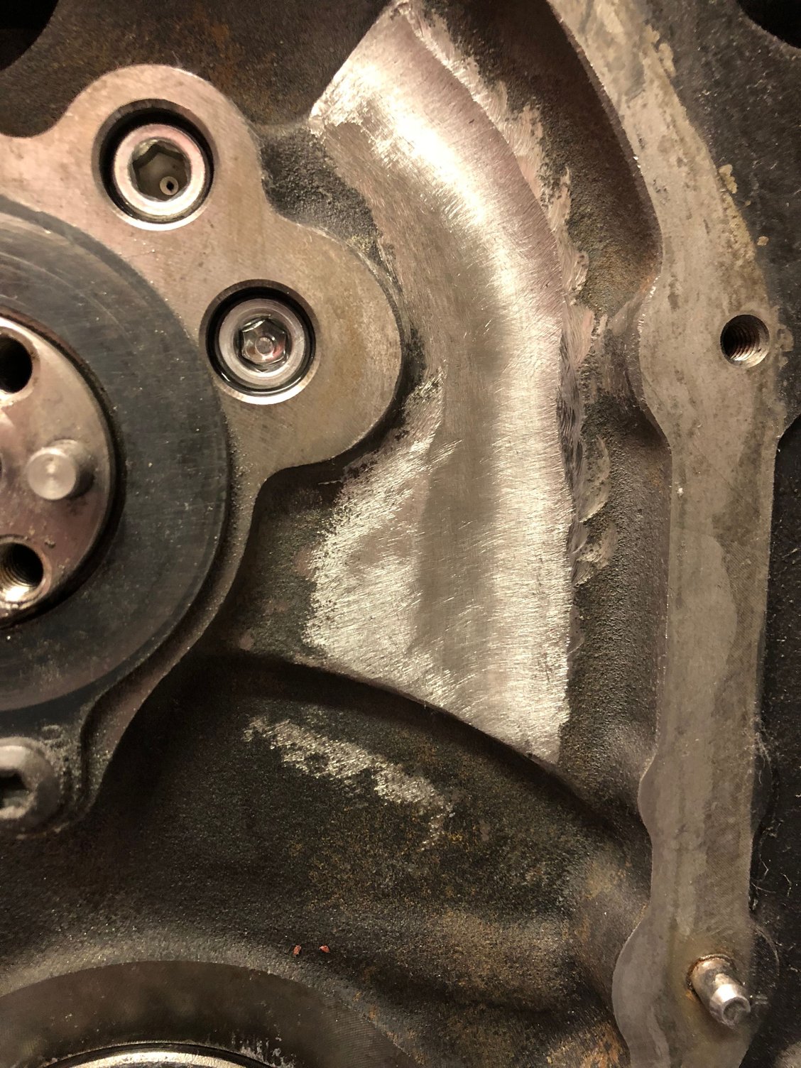

It aint pretty but oughta do the trick.
How's the block clearancing going?

Old 07-11-2018 | 03:57 PM
  #54
Joined: Jan 2018
Posts: 198
Checked the gen 5 cover and it is .5" at the high points which are stamped inward so I don't think clearancing them is an option if it doesn't fit.

Old 07-13-2018 | 07:02 AM
  #55
articfriends's Avatar
Joined: Jun 2004
Posts: 7,318
Likes: 1,037
From: frankenmuth michigan
I just used same roll masters on 2 gen 6 454s and a gen 6 502, sanded the ribs in timing covers, they rubbed slightly just turning them over by hand, sanded high spot on all the blocks w air sander too, no big deal other than you want to do it if possible before motors ckeaned snd assembled. All 3 of mine had .010 clearance between pins on chain and block before clearancing but if chain ever flopped at sll or w as lked around it would possibly rub, Smitty
