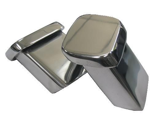

cannot check or clean the breathers as it has this style venting. It just started doing this in the last 5 hours or so

Pull the valve covers and check for blockage in those breathers (I dont believe there is a media in them...but I have been wrong before and will be again).....with low oil temps like that condensation can make a milkshake gel in those and plug up. IF they are clean/clear it is time for a leak down check.

My 454s with blowers did that after i replaced the valve cover vents ( 2 per motor ), it was the foam in the vents saturated with oil causing the pressure. I removed the foam and no more oil out dipsticks or the rear main seal.

I will pull the valve covers and inspect for blockage and go from there. Thanks
