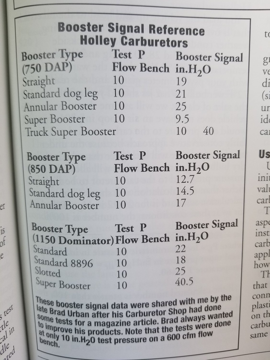

keep in mind not all carbs are equal. Cfm rating is simply how much air they can move thru them. It has nothing to do with fuel atomization. You can try 5 different 1050 dominators, with different booster styles, venturi sizes, etc, and get 5 different results on the dyno.
MILD THUNDER 10-08-2018 03:10 PM
https://cimg6.ibsrv.net/gimg/www.off...3d3ae375d7.jpg
