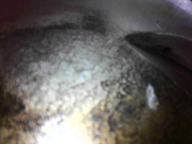

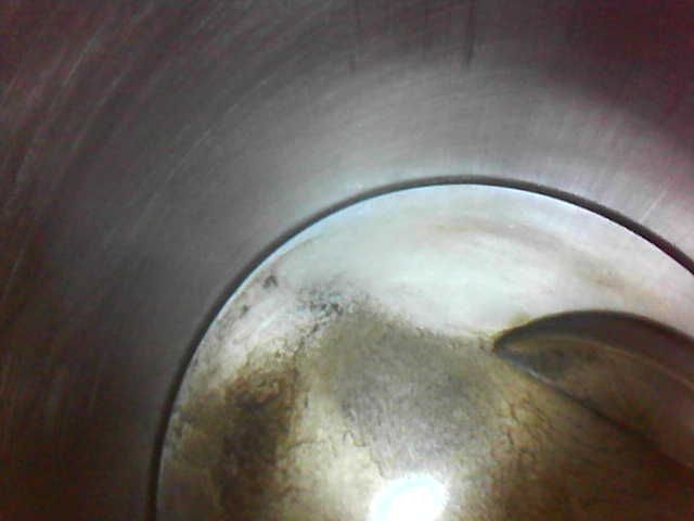

I am looking at a rebuilt 572. Cylinders were honed, new bearings and rings. Engine was dynoed and fogged never ran in boat.

First two are not so clear but looking at the third mames me think it looks new!

going to get stuff like that upon startup, and if fogged maybe more

tough to tell anything from the pictures....but nothing raises my eyebrow.

Looks 100% normal. Run it.

Upon investigating further it is just fogging oil and dust from the exhaust valve being open. Wiped right off with a q-tip. Bought the motors.
