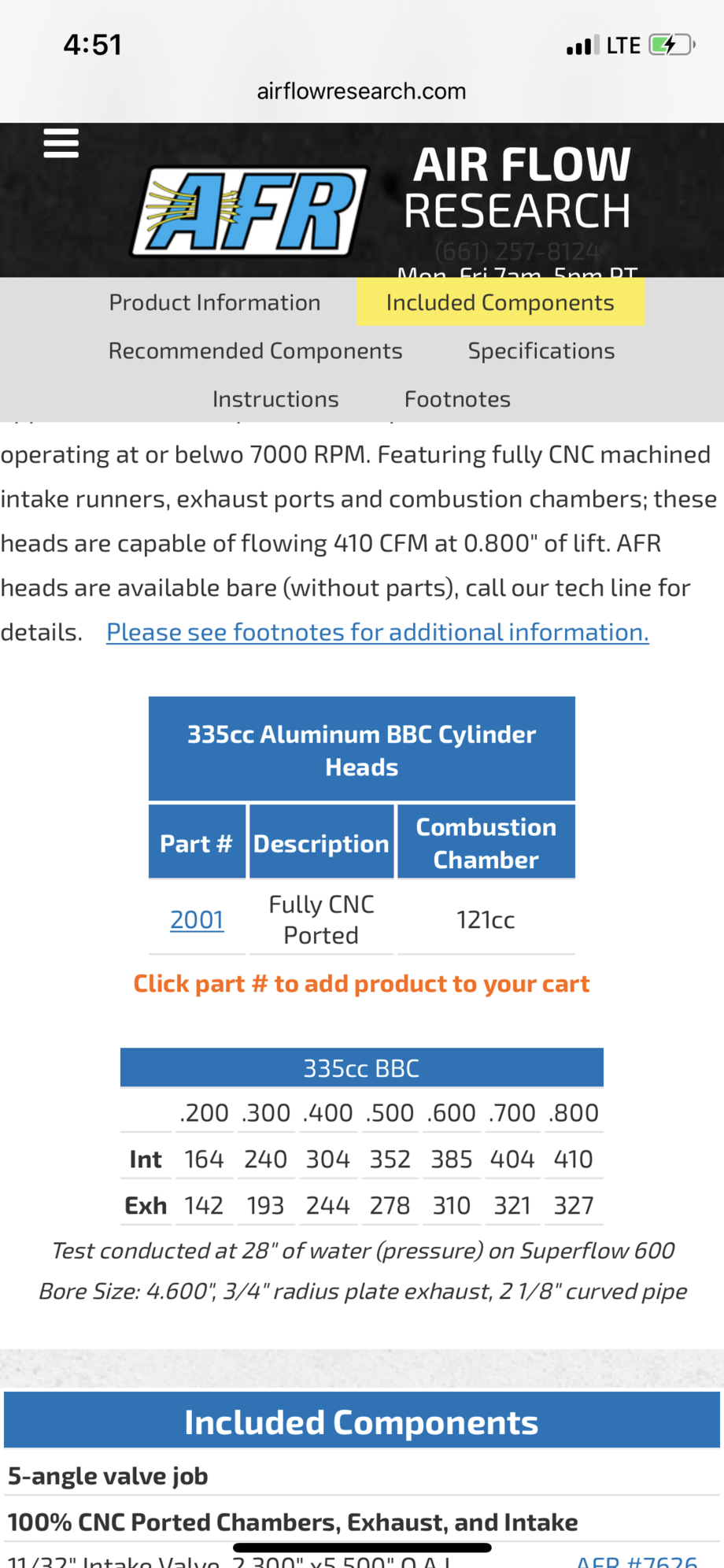

That’s good advice!! I can make the switch the shaft mounts!! Your personal opinion would I benefit a decent amount of horsepower with cnc afr 335 vs dart 325?? I feel like the afr would make more power because they flow better on intake side, but flow considerably better on exhaust side?!?
I just ran a set of Brodie 332 oval ports on a 557 made 1050 under 7lbs boost. Brodie has some good stuff may want to look into them.
HP is limited by the air and fuel that can't get through the motor, the better flowing heads (without being excessively large) with the right cam, intake and exhaust will make the best power. Maybe have someone flow your 325's and see how they compare to the 335. Are you staying with the 509 ?

Pretty sure I’m goin to purchase afr cnc 335 heads, unless there is something better?? Seems those have really good flow numbers for not being too big of a runner volume!!?

These are better if we’re racing flow benches.
https://brodix.com/heads-2/big-block...block-series24

I bet the brodix have better shape runners and more air speed. Probably cost more too
