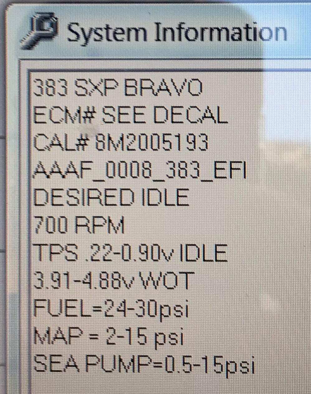

This is the 383 stroker scorpion bravo. 6k rpms was stock.

you have the older reman 400 hp --- 383 Stroker it was offered for not many years and ended x amount years ago. It was only offered as a Merc reman inwhich is not remaned by Merc at all. But Merc has their name on it and covers all warranties. Maybe it was offered for 4 straight years or ?? was not in their line up for long.
Not sure if that fuel pressure is correct in the listing you posted as I think it was changed ???
The engine you have is somewhat a rare engine thru Merc in its a day being the 6 K --- 400 hp engine. . I would rather have the 383 than the 377 inwhich the 377 CID 6.2 was in their new production side as well.
Like I said the 383 only came as a reman engine thru Merc and was not offered in their NEW production line up.
