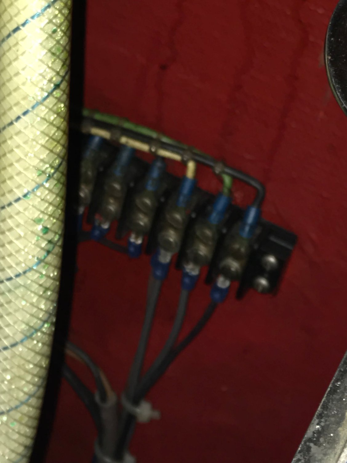

I realize that - I have no idea if anyone else pointed that out but I did. Get it all done for a safely correct install. Harbor fright spade terminals in a boat is improper install PERIOD. Also they provide extremely poor connections and all are exposed. You have prob bad power and grounds on top of the mix. Good luck with it.
The sad thing is it had a survey before purchase, I really am starting to believe a lot of those are not worth much. A good motor guy and a good fiberglass person would be better,,,,,,,, but again expensive.

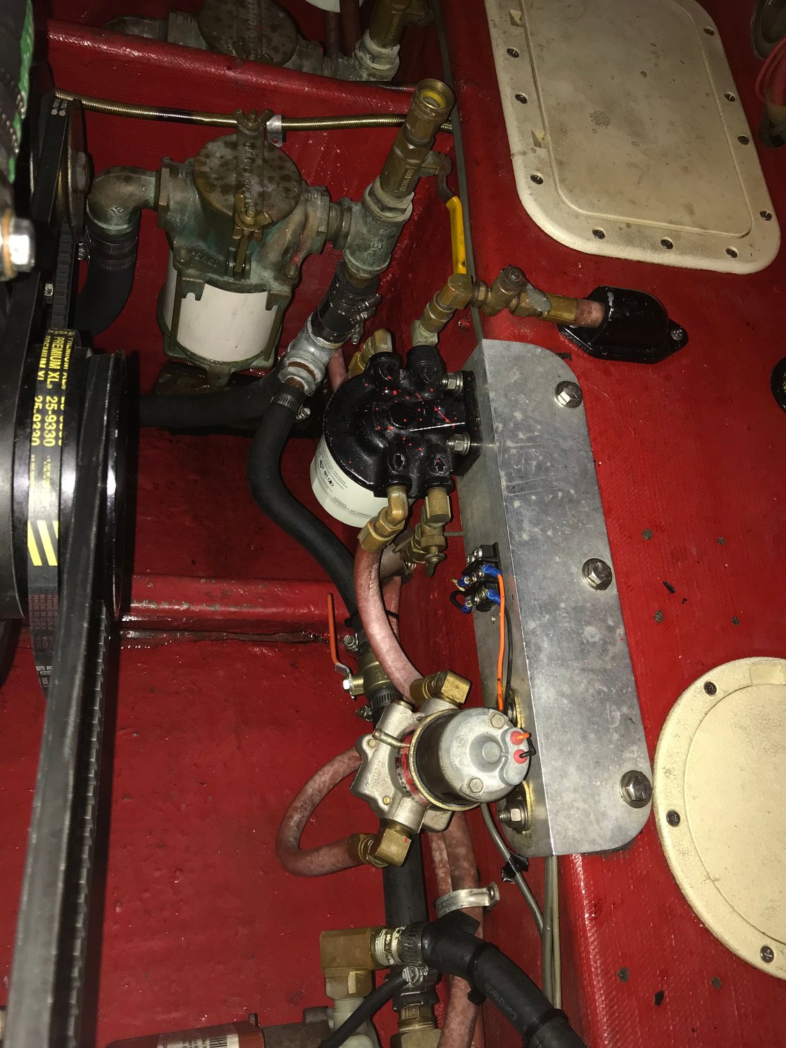

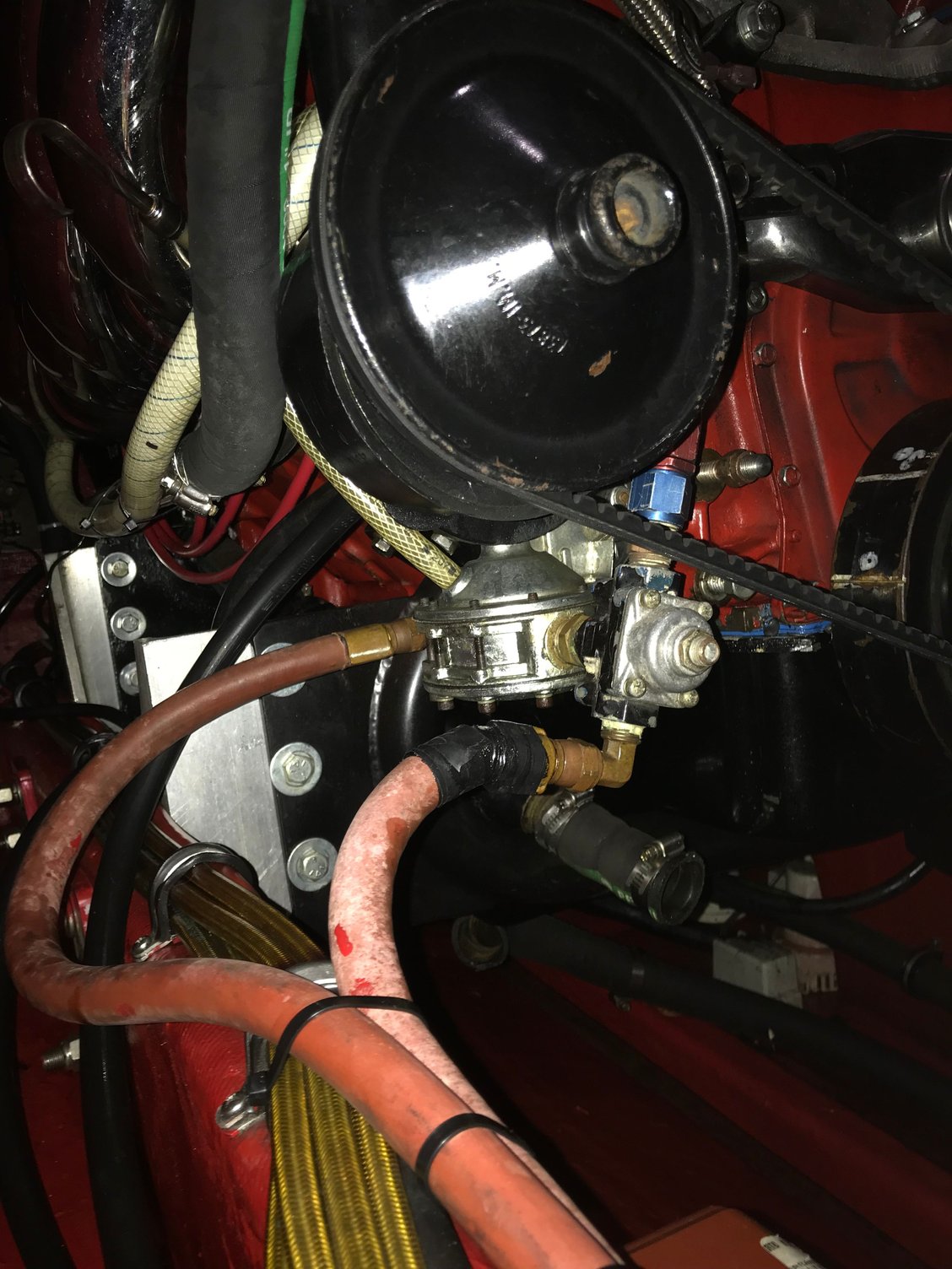

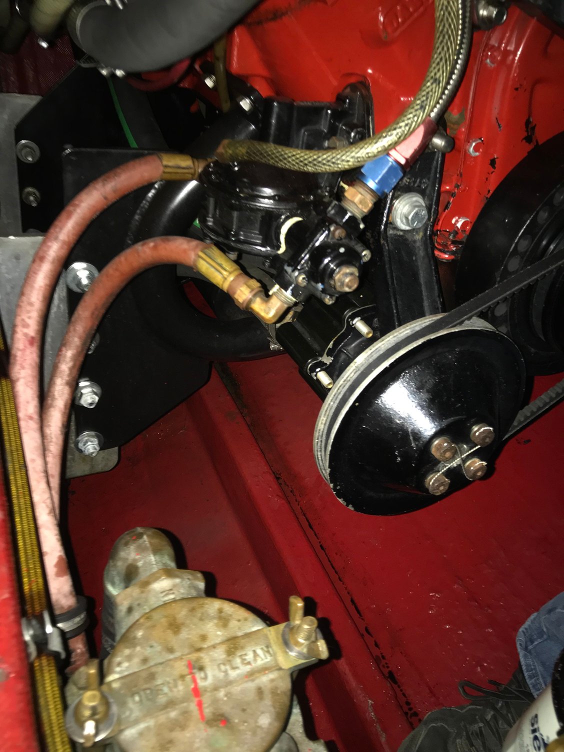

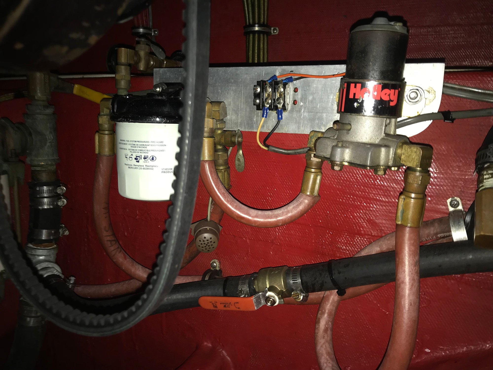

Went to barn and took pics, seems I have a return to filter head, but not the tank, then both filter heads tied together with a shutoff valve, tons of fittings that suck but still feed 600 hp with ease, no clue how but it does. As for connectors well every boat I had has the same crimp connectors not sure what else you use..?? I do know this fuel setup has always been same since new.

Fuel pics didn’t load try again.

That mechanical pump you have Full Force, by itself will support 900hp.
personally, i see no good valid reason, to have all that extra nonsense in there. Carb fuel systems are cheap, and easy to set up. A simple baker style six valve pump, with a good sized fuel line and water separator, and done for under a couple hundred bucks per engine.
i wouldnt run one of those holley red pumps on a street car with a 454 , let alone an offshore boat with a hot 540+ci build. Jmo

agree, this is only this way because I left boat as is, I am getting rid of all that and going to located the seperaters with bigger inlets like I did mistress. I was just using mine as example of it not being his issue unless pumps are bad.
