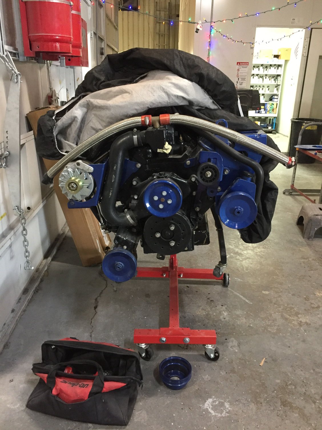

Came on a Bulldog I purchased, trying to find what model these also came on to get a FWC system

looks also like the 502 mag mpi stuff, I have some parts if you need them

Got a email reply , a 7.4/l mpi has the same brackets. Mystery solved.

just used that belt set up on my tall deck chevys. from a 98 454 mpi,

If you dont want to pay Merc's price on a belt get your self a Dayco, PN: 5061050 belt
