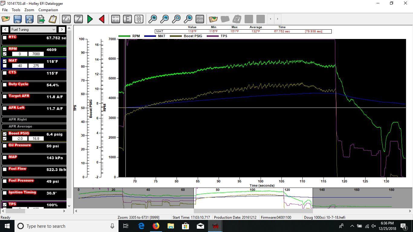

Here's a datalog from a recent run.
I have the intercooler water coming off my crossover, so MAY be a bit cooler if I had a dedicated pickup.. ..
Lake was about 78 degrees IAT went from 118 to 151 in 55 seconds WOT 11 PSI.....

That's what I was thinking. I thought they created a lot of heat. Your running a decent amount of boost, I was wondering how hot the air gets in the in the 4-7psi range. Good looking setup you have their.
