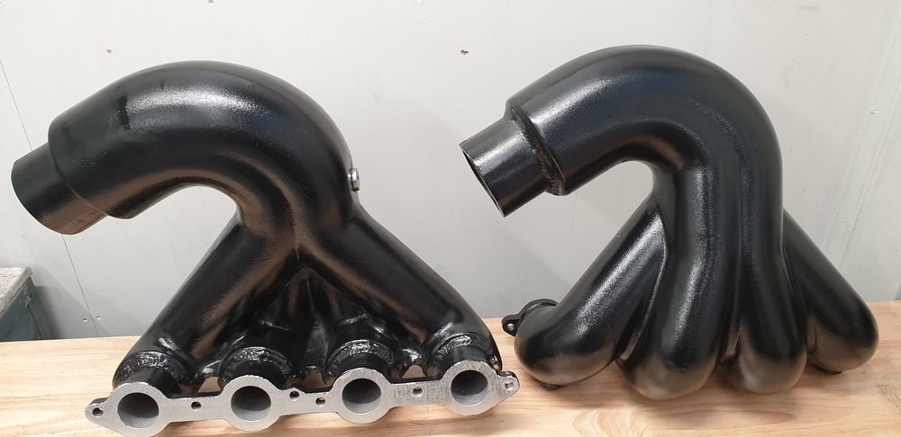

Look what I found. Harris Marine - new zealand. Full aluminum jacketed headers for 1600 usd. Hmmmm

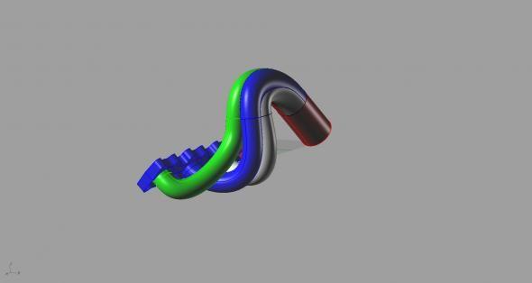

And a cad drawing

Bad thing about those is, I don't see how you would be able to make them dry. Like ezstriper said, almost every successful LS swap I have come across that has any kind of cam at all has dry exhaust.
SB, I really like your idea of 2-into-1 exhaust, if for no other reason than it would sound nasty!!!!
Those are interesting, they make anything for BBC?
