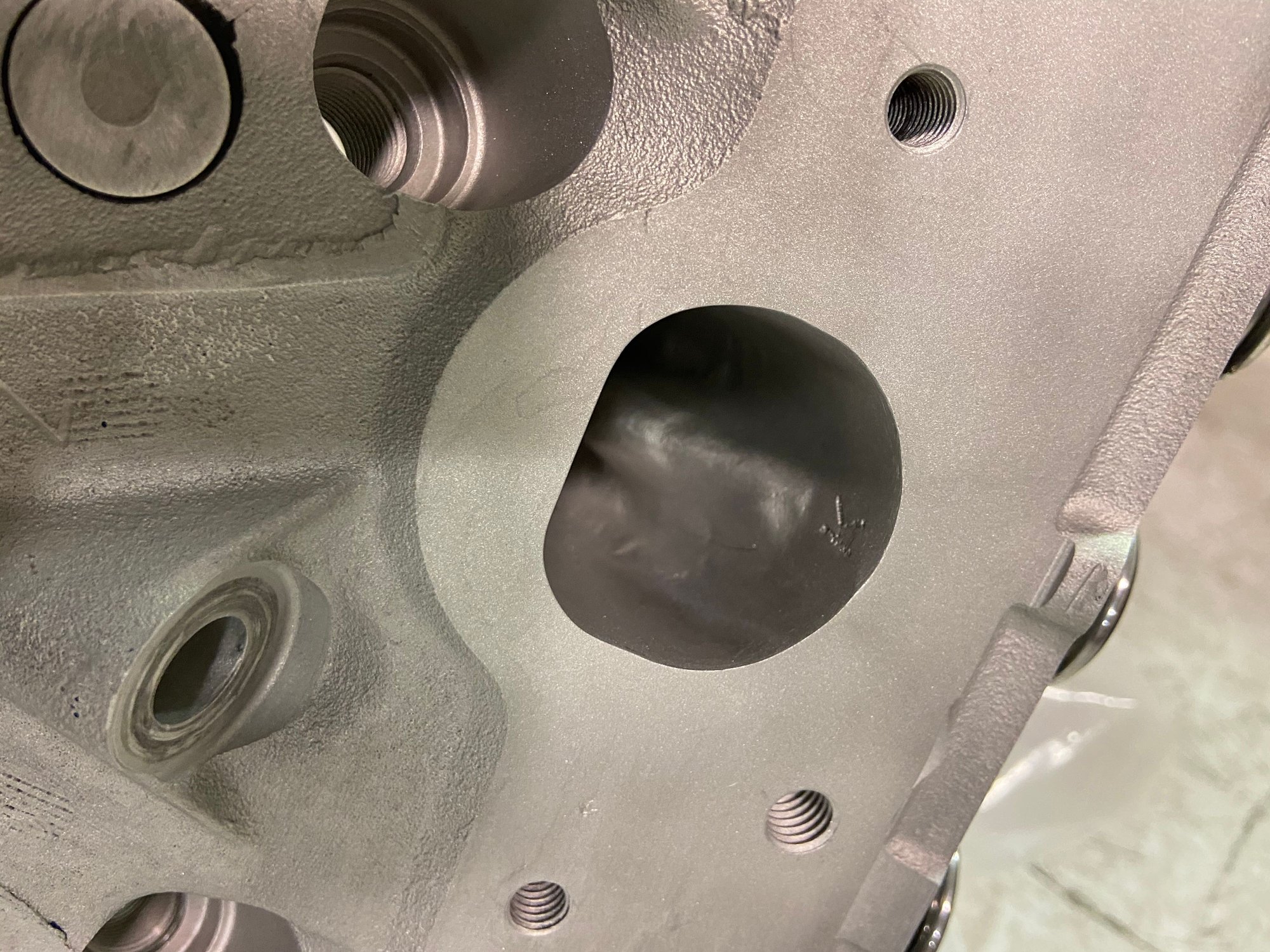

So the port work is mostly cleanup. They went from 260cc to 267cc runners. Also reshaped the chambers. Notice the area right behind the spark plug. We shortened and laid back the quench pad to slow fuel burn. Ferrea 6000 intakes. Super alloy exhaust valves

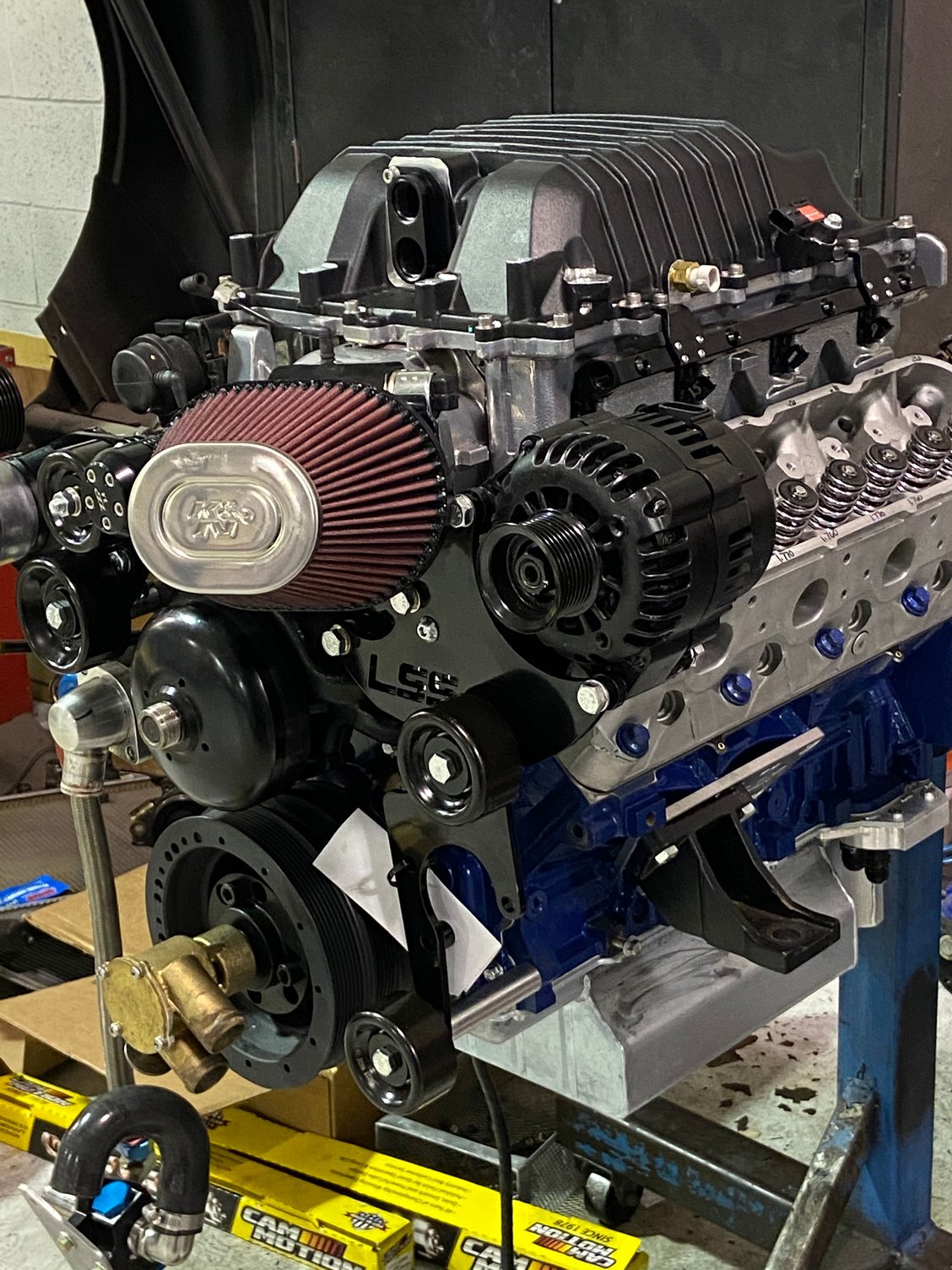

I will be updating here shortly with build pics. The engines are just about finished. Will also update build specs
