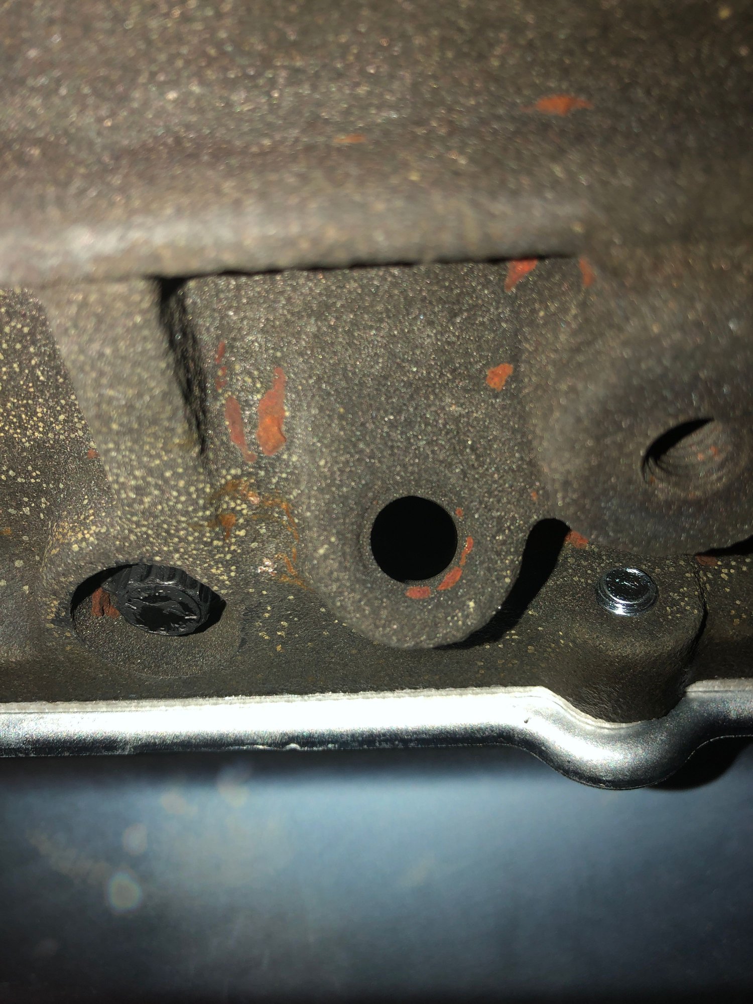

The ls engine actuallu fill the heads at high rpm and do have a bad history of draining pan. Very real concern on these. They have minimal drain back. The holes in the tray being at the top by the valley only slightly helps but none the less does help. I also tend to run .050 restricted pushrods opened to .070 vs the standard .100. Still plenty of oil but keeps it on the bearings more where its needed. This baby has every mod I am listing done and trust me she is ran hard ( pro touring events)https://cimg6.ibsrv.net/gimg/www.off...c88bdfa8f.jpeg

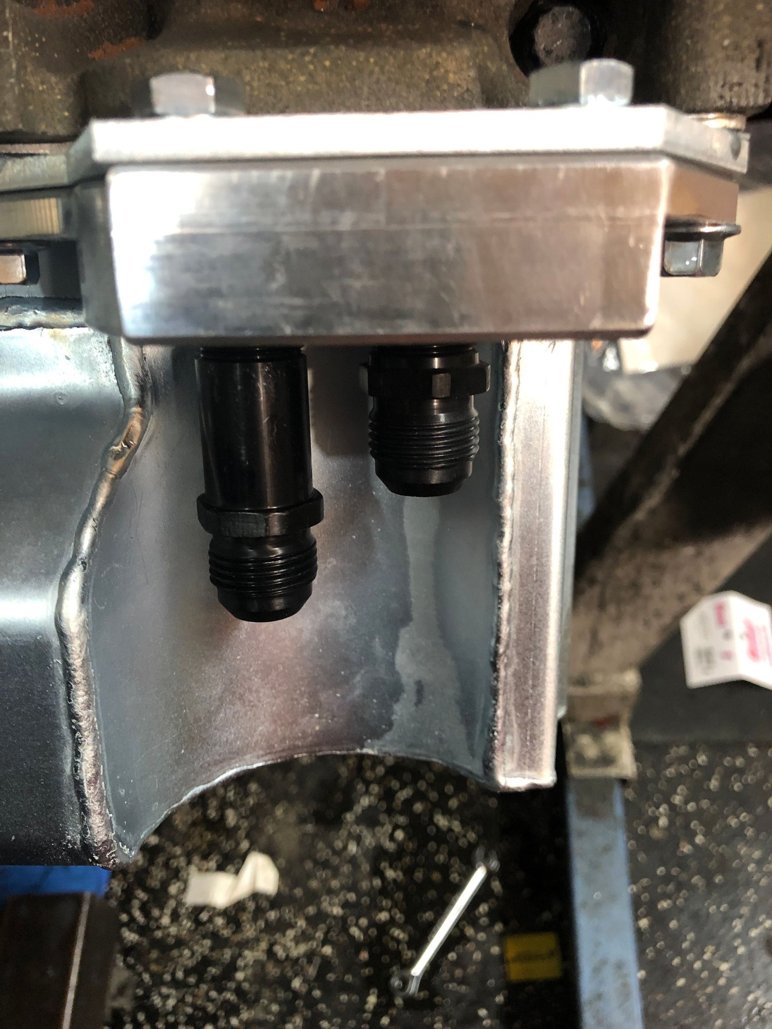

mggdoors 02-01-2019 02:28 AM
Originally Posted by Hot Rod 29 (Post 4670656)
tell me about that oil pan. Does the stock pickup tube work with it? What is needed to run a remote filter from the pan?
Champ oil pan. Part # listed in first post. 4 trap doors rear sump. Windage tray. Very very nice pan. Billet adapter that also eliminates oil bypass. Dipstick on ls goes in blockhttps://cimg2.ibsrv.net/gimg/www.off...01dea2f3a7.jpg
https://cimg3.ibsrv.net/gimg/www.off...134d7c697f.jpg
