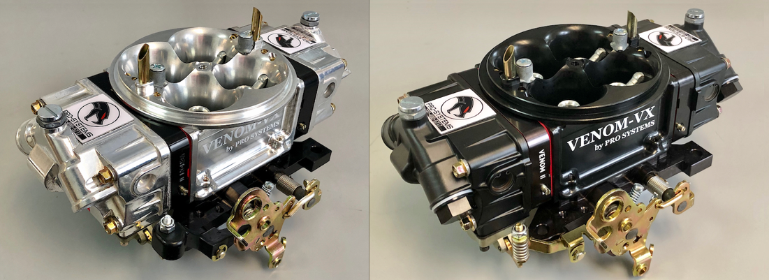

Decision on fuel system is made. Pro Systems Venom VX 1050 annular. Now for the color. Haha. https://cimg4.ibsrv.net/gimg/www.off...28b475a796.png
mggdoors 02-01-2019 10:42 PM
Originally Posted by Hot Rod 29 (Post 4670755)
its 120 per block. I just weighed them. I have a set of 6.0’s I was going to build.
I just ordered a set if those oil pans. Thanks for info.
I also bought extension boxes, raised the drive height, and some more weight savings throughout the boat.
You will like tge pans. For the money zero complaints. I did get mixed opinions from them on whether or not to use the factory windage tray as well as the pan windage tray. I will be running just the pan initially. I honestly dont even think with having to soace the windage for stroker that it will clear the pan windage. Hopefully you got a goid deal. I have an account through them and could have gotten you a break.
